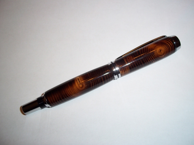

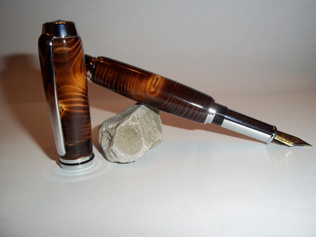

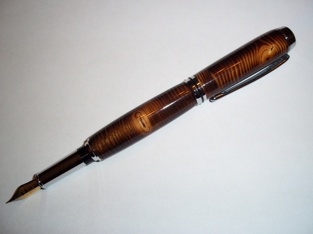

my pen arrived in texas and as gary is without a camera right now let me post them myself. glad you like it gary. pith was fun. i'm almost looking forward to the next one, almost.

i wanted to follow the rules as close as possible. this is an honest to goodness 2x4 from a local lumber yard. a left over from some shelving supports at work. i cut my blanks across the 2x4 to give the pattern you see. i tryed to stain it at first but pine doesn't stain well especially end grain. so i sanded it and burnt it with a propane torch. very carefully. this is of course after the blank exploded three times. i was so happy with how it turned out and got so much intrest in it at home and work i couldn't bear to part with it. i finished it only a week after sighning up for pith but only sent it last week. thanks to some possitive encouragement from a fellow iap member. now i'm glad i decided to send it.
Absolutely fantastic!!!!!
Very unique piece of wood, and spectacular work on the fit and finish... The grain pattern in relation to the pen is brilliant!!!!
That is one beautiful piece of timber. I have never said that about pine before, not ever.

Great job you done there mate...!:wink:
As soon as I saw it I knew what you done with the pine wood, in fact, the colour gives it away, as no other system will produce anything even close...!
The torch surface burning, is a very old method use with pine woods, from the simple surface coloration to the more deep effect when the burning is a little more "persistent", something that wouldn't work well on a pen barrel being so thin wall wood but, the light burning is certainly very effective on a good selected piece of pine.
Is the resin within the wood that does most of the effects work, apart from the decoration side of the burning, I remember well to use an old style gasoline torch to slightly burn the pine surface to force the excessive resin to come out, as the heat would melt it and push it out to the wood surface. After dry/cool down the surface was then scraped and sanded down to a smooth finish in preparation to either oil painting or cover the wood with a serious of coats of a past that was home made in those days where the Lindsey oil was one of the main ingredients, that had to be boiled by us in old pots that would stink the house and everything else a mile radius for days and days. I just can't remember what this "past" or the method of application is called, damn...!:mad:

It is an awesome pen!!Going to be my new carry pen at work!the finish and fit are perfect,I couldn't have asked for a better pen!thanks again,Marc!
Very nice Marc! I torched your pen a couple of times too, but it didn't turn out nearly as nice as this one. I won't say anything else about yours since you haven't gotten it yet.
