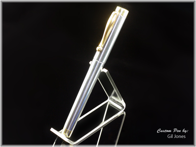

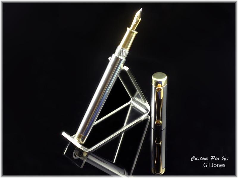

Here's the PITH pen I made for Monty. In the spirit of the activity I attempted something new which was to make my first metal pen. I was going to use aluminum for the body and cap but at the time all the aluminum I had lying around wasn't big enough so I said what the heck I'll use a piece of steel. So this was made from one of those zinc plated steel rods from Home Depot. My taps and dies are still complaining they did nothing to deserve that torture. The finials were made from brass. One of the trickiest parts for me was getting the taper on the body. I manually backed out the cross slide dial by hand as the power cross-feed was driving the cutter into the part. It took several passes.
Then I had no idea how to polish metal. I started with a file to fix the taper then I ended up starting with 80 grit sandpaper and working my way up just like I would with an acrylic pen. It worked...it just took longer. In fact not sure if it's an accepted method for metal but I wet sanded with micro-mesh. I wasn't sure how to protect it either so I'm afraid it might need a rub down with oil periodically like a rifle barrel.
I was worried about the pen being too heavy. I didn't weigh it but when I let friends check it out you could see their hand drop a little as the unexpected weight of the pen took hold. So Monty if it's too heavy for writing it could be used as a weapon...I was calling it robo-pen.
Hope you enjoy it...it was tough to part with my first metal pen.

The picture doesn't do it justice. I like the contrast of the brass finials to the barrel.
Yes it is a little on the heavy side, 107.2 grams, as weighed by my HF scale I use to weigh out my PR, but it seems to balance out nicely in the hand with the cap off for writing. Plus he used an nice tu-tone Heritance nib on it. (Although a 14k gold nib would have really made it an outstanding pen. :eek::biggrin::biggrin::biggrin:)

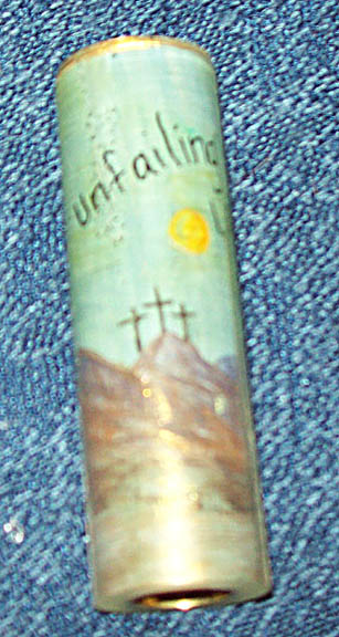

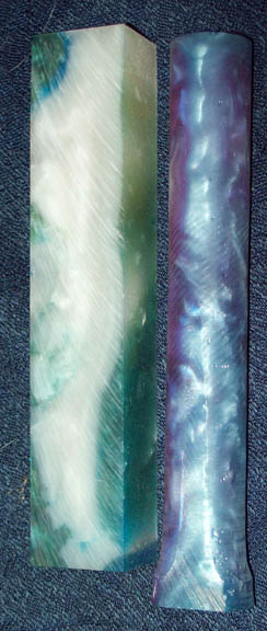

I finally had some time to take pictures of the blanks Gilrock sent along with the beautiful pen.
This is the Sierra cross blank
These are the ones he cast.
