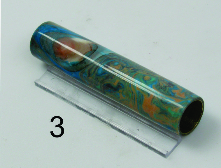

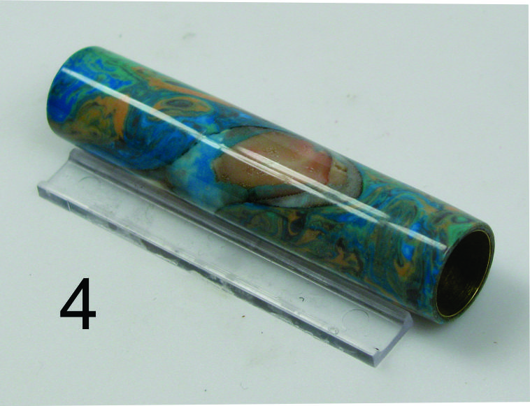

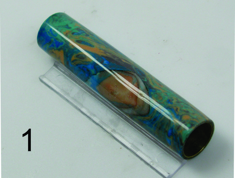

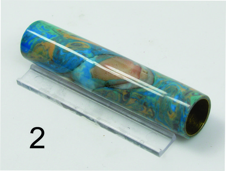

After doing the video, I have done the second pen.
On this one, I did a "quick" application of thin CA, after sanding with 400 and 600 grit. I am pretty happy with the results.
(I allowed the CA to cure for an hour, then sanded it with 600 grit to smooth it out. Last, I did the same Tripoli and white diamond buff that I had done on the Pirate Bone yesterday---the results were MUCH better today--see pics attached.)
As you can see, the "reflection line" is uniform, across the "pirate bone" section.
