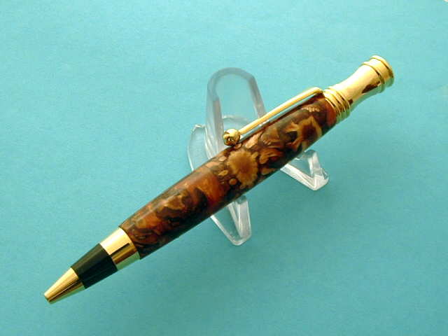

I can fix you up with some pinecones if you're interested...I have a virtually unlimited supply. They don't have a very big core and will be difficult to drill bigger than 7mm without blowing up. Some are even too small for 7mm. I've been experimenting with casting them with some success. Finished this one today. Drop me a PM if you want me to send you some. By the way, my wife is from Round Rock and I grew up just down the road in Hutto.
