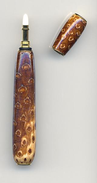

I just made this about 45 minutes ago. White pine cone cores, medium size one for the body and a small one for the cap. I had a tough time turning it as I soaked it in thin CA before turning and it got rock hard, had to use the tip of the skew to get a bit started and then took it down from there. Two coats of thin a four of medium CA to finish, polished with micromesh then a buffer.
