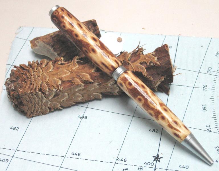

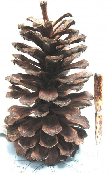

Owlelope, I don`t cast my pine cones. I use the long leaf pine cones.
The photos will give you an idea of their size.
