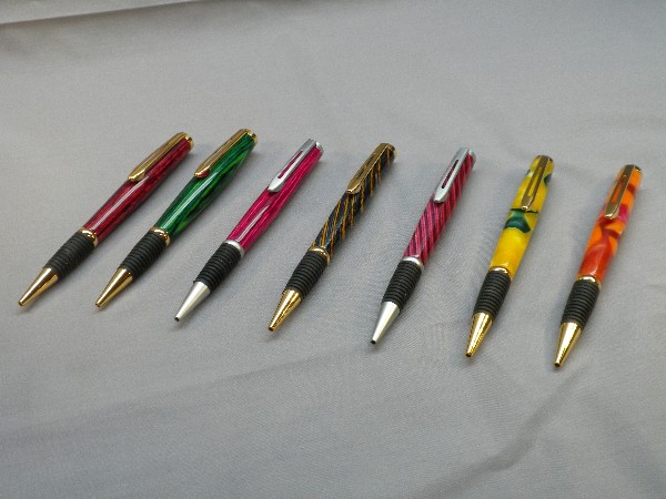

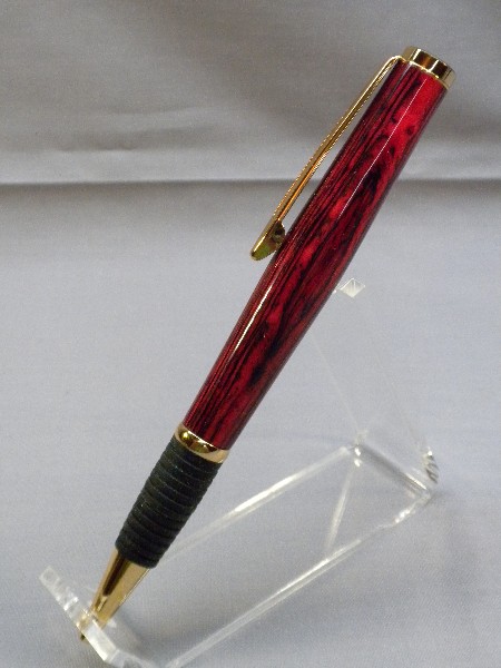

The wife asked me to turn some pens to give to her workers as gifts for special achievements. She didn't want a really fancy pen but something they would find comfortable enough to work with every day. I had been wanting to try out the Longwood from PSI. So I got some kits and turned a few. I really like the way these pens look finished and they are very comfortable to write with. I also tried a new type of wood blank (for me) called Dymalux from River Ridge Products. They are similar to Dymondwood. The three colors were Hot Pink, Chili Pepper and Chartreuse. The colors really pop and I've already ordered more blanks as well as kits.

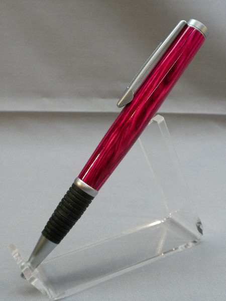

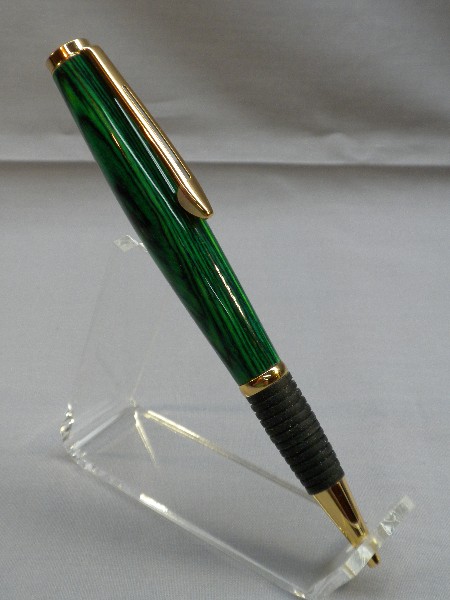

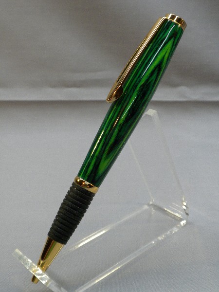

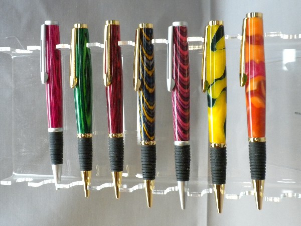

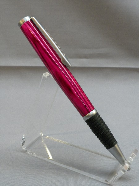

Here's a couple of better pics of the Dymalux pens. The first pictures don't do them justice.

I like the blanks, but the longwood kits have always just looked a little off to me.
How comfortable is the rubber grip? I have thought about doing a pen or two with the grips for comfort, but can't decide how they would feel.
Nice work and interesting blanks. I'm sure they will be a big hit!
I have make a few on the PSI longwoods. The women seem to like them. I have made some with the cushion grip, some with matching wood and for a few I used ebony on the nib end for a different look.
I really like the long wood kit as well. It shows so much more of the wood then your typical slimline pens. I like to do them without the comfort grips as well. It opens up the possible combinations of woods and designs so much.

Nice looking pens. This is the first time I've heard of the Dymalux. Could you comment on how turned, took a finish, etc? Looks like you put a CA finish on them from the nice gloss apparent in the photos. Thanks for sharing.
They were very easy to turn. I used my Easy wood mini rougher and turned down to just proud of the bushings then sanded 80-150 to finish. I applied 3 coats of ca thin and about 8 coats of medium ca then wet sanded/polished with 600-12000 pads and applied Renaissance Wax. The pictures really don't do the blanks justice. The finished look is very deep and colorful.
