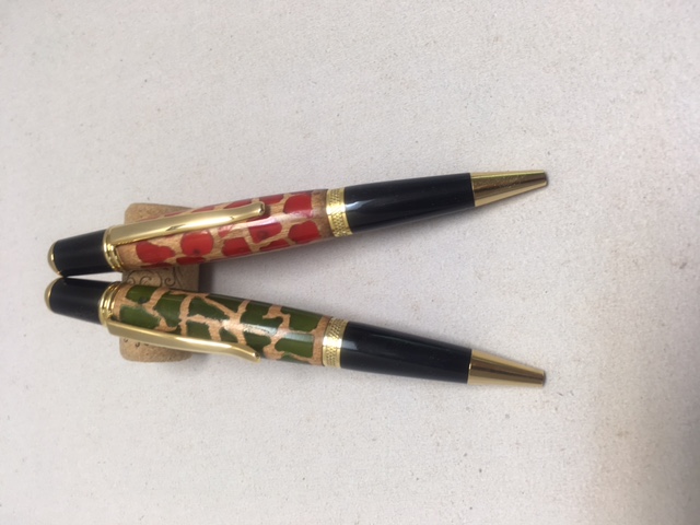

These are a couple of pens that I made last week, using my new homemade piercing tool (less than $80). Although I've been making pens for several years, these are the first pens I've posted on the site.
Started with a mahogany blank, drilled it for a Wall Street II pen tube, mounted the tube and blank on the lathe (not glued) with bushings, and turned it down to almost the final size. Took the blank off the lathe, drew the piercing pattern on the blank and cut it out with the piercing tool. Glued the tube into the blank and cast it in PR. From there, just turned it and finished with CA.
Sorry for the picture - still learning how to take good pictures and then post them.
Comments and suggestions welcome!
