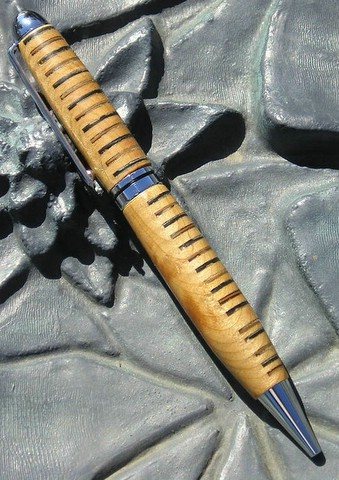

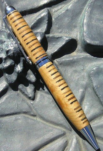

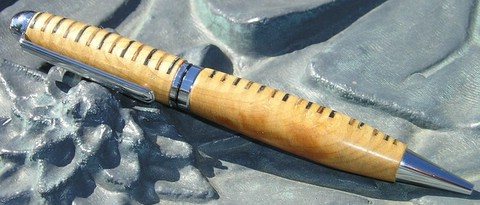

This chrome Euro-Mont is an experiment in symmetry and segments. Gluing up segments is not at all hard but where it gets tricky is to have the pieces line up straight once the turning has stopped. I wanted certain cuts to 'stop on a dime' and this was managed with slotted controlled cuts that were embellished with a black & brown backing paper in alternating rows (or segments). The main body of the pen is solid cherry and the paper was glued to the slots in a reverse grain pattern but only to half of the body. Straight cuts were part of this exercise as well as to stay within the lines. Your 'cutting' comments are welcomed.

Peter: I have no idea what you are trying to say BUT the pen is awesome! Are you saying that the inlaid stripes are paper? Oscar
Oscar, correct. The inlaid stripes are paper (black & brown).
Billy, I have done inlay w/ veneers but wanted to try something different. I wanted the 'challenge' of the smaller cuts and avoided a larger glueup.
-Peter
Wow!!! I'm impressed[:0]! That's a lot of cuts to get lined up[:0] and filled with the paper, and not have gaps or something wrong with it.
Peter, you are crazy. The job is well done, but I'm still trying to figure out why you put yourself thru that. I'm sure that the skills you practiced with that will show up in some spectacular fashion soon. Meanwhile, that pen is sure to get comments. Nice job.

I like your symmetry and cool design. Do you mind letting us know how you made your cuts? What type saw / blade did you use? Thanks,
Although it looks like a lot of work (straight cuts) it isn't. The industrial frame saw (Wintersteiger Co.) makes the cuts routine. I'm lucky enough to have one at work. Inserting the paper into the slots was both messy and time consuming.

The precision of the cuts appears to be dead on.
Made with the right woods I can see a "real" hand made piano key pen without the aide of a laser.Truly one of a kind. GO FOR IT!
