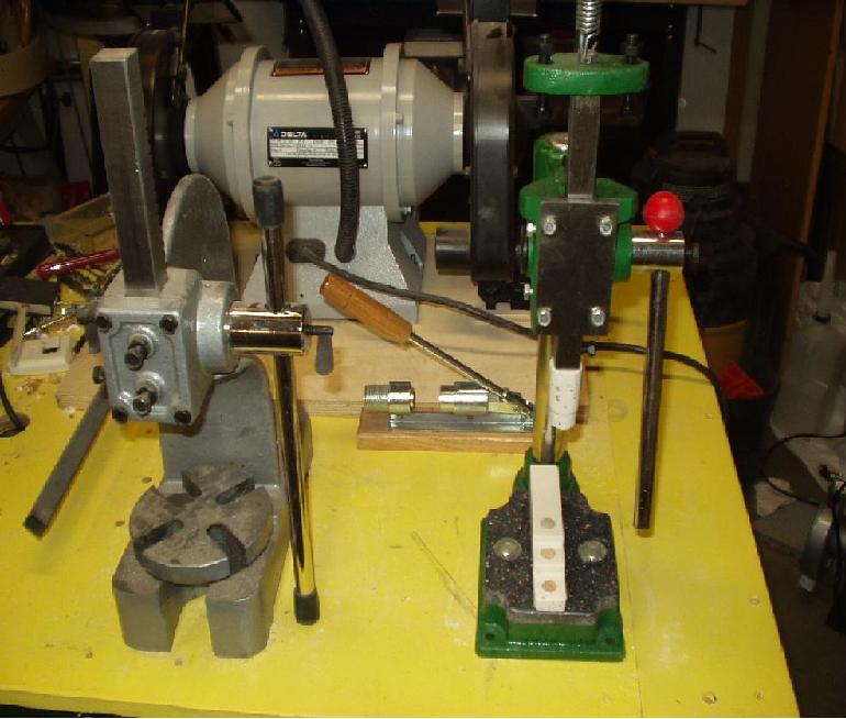

woodman928, I did what you said and it did look like there was a spot inside to hold that plate, so I left it in there. But that alone didn't do anything. However, and I don't know if this is the correct way or not, but it worked. If you look at the pic of the press on the left in (jwoodwright)post, you will see two set screws sticking out the front where the handle connects, I just barley turned both screws a hair and it put enough drag on the shaft to keep it where ever ya need it. And that plate is right behind those set screws. [

jwoodwright, nice setup you got there, did you make that little press in the back ground? Your press looks just like mine except yours is Grey and mine is green. Is yours from HF? Thanks for the input, I did in fact try putting that plate between the teeth and it does keep it up, but to me that would be a pain playing around with it all the time. But I guess it's what ever you get used to, hey?
