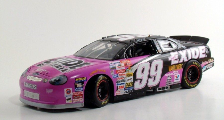

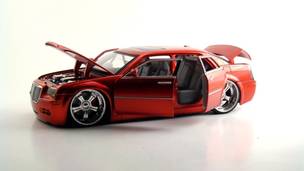

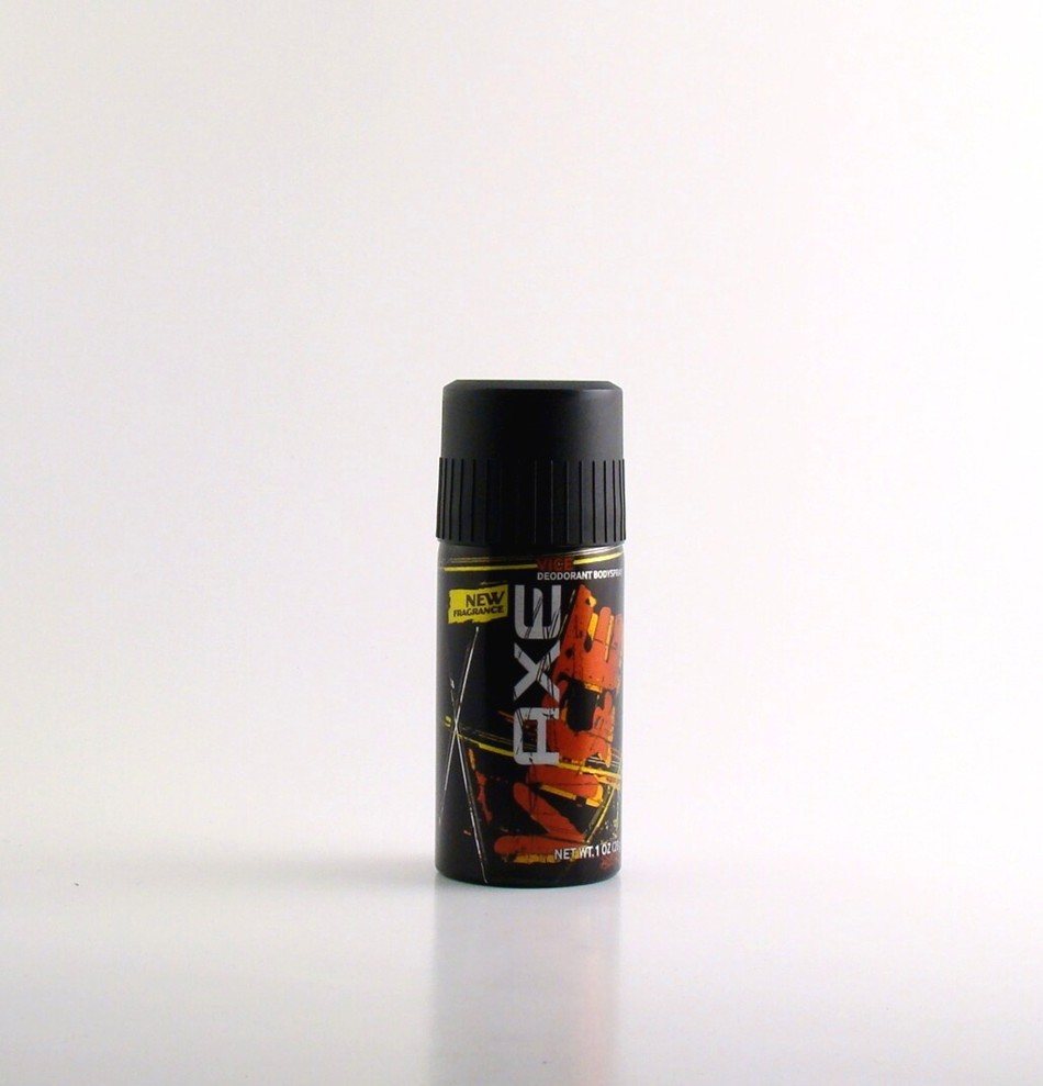

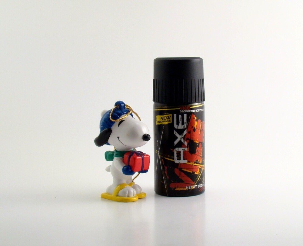

Ok, Here goes it. Now some of this is kind of goofy to take pictures of, well thats what my wife tells me right after she called my a geek. I have taken pic's of just about every thing I could fit in my light box. I have adjusted this camera to no end.
F-Number: 5.6
Exposure Time: 1/40 sec.
ISO: 100
Exposure Compensation: +1.7
F-Number: 8
Exposure Time: 1/15 sec.
ISO: 100
F-Number: 8
ISO: 100
Exposure Compensation: 0
F-Number: 8
ISO: 80
Ok, thats what I came up so far. I tell you If I keep this up I will end up with another hobby[:D][:D]
Tell me what you all think so far. Remember this is my first digital camera I've had it about a month now. Also all the adjustments where done with the camera and moving lighting around. Always looking for helpful hints
Thank[:)][:)]
Looking good. My only comment is that on the last photo the back corner of the car is slightly out of focus. If you can increase your f-stop to f11 or f22 that would solve it. Otherwise decrease the angle of the car to match the car above it.
Nice models, by the way!
GK
Greg,
I think he's stuck with f/8.
I think you've made some giant steps since the first pictures you posted. There seems to be a LOT more light on the right side. If you can adjust it so the lighting is even all the way across, you'll have it nailed. Like Greg said, decrease the angle. When you're taking pictures with the camera this close to the subject, the depth of field(part that's in focus) is extremely shallow. Having a long subject, like a pen or model car, and putting it at an angle is sort of like shooting yourself in the foot. Try to get the subject as parallel to the camera as possible to maximize the depth of field. But, you're almost there. And, don't sorry, photograph the same pen again, we don't mind. That's what this forum is for.
I agree with the giant improvment. I realize you are limited to having lights to each side do to how the tent is shaped. having said that I will also add that this leaves most of your photos dark toward the front edge of the subject. I noticed right off that the detail in the cap of the axe can gets lost just left of center on the front. snoopy looks good but the focus is just a touch out. the last photo looks best to me as far as light to the front as well as good detail all over. Again focus is just a bit off. I can never be sure if the focus is really off in the original photo or if detail has been lost posting it here. you need to look at how sharp the originals are on your computer. Auto focus is a bear when it comes to macro photography. backing the camera away and zooming in will help. you can also take a photo that the pen gets lost in and crop it all out later.
one other issue you seem to have managed to concure maybe without trying is color balance. white looks white etc. in these photos. it looks to me like the colors would all be correct. Anouther thing I noticed. in the snoopy axe photo you have black and white subjects. You don't get more drastic contrast than that and your set up handled it very well. I can only repeat what greg said about the car fading from focus. the f stop or apature setting controls how deep the area in focus is. I don't know if you need f22 but that would probably guarantee alla the subject would be in focus, and the background, and the wall behind that. Personnaly I don't like my backgrounds to be in focus, I can also read the camera lens and know exactly what will be in focus and what will not. I incourage you to keep playing with the camera. If your wife thinks it's weird then prop her up there and snap a few photos of her. she will be flattered and feel like you are spending time with her. maybe ask to take a shot of her hand showing her wedding ring. when you can lift her fingerprints from one you know you got it right.
