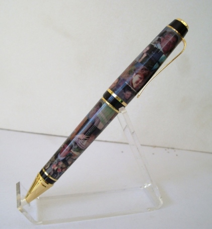

Tried to paste VERY SMALL photo's, printed on a ink jet, onto the turned barrels of a Cigar kit. Finished with 15 coats of Modge Podge then 10 coats of CA but did not end up as I would have liked. :frown:
Got to give this another go! Comments welcome. :smile:

Seems clear, but a little dark .. did you paint the tubes at all?
Some papers will let the color of the tubes bleed through once they
are wet with resin. White usually stops this, but they still darken
a little bit once you put resin on them. There are also some computer
labels that are meant to block color from going through. I think they
are heavier labels .. more opaque. The Avery TrueBlock labels are
supposed to help with this.
Nice job!
