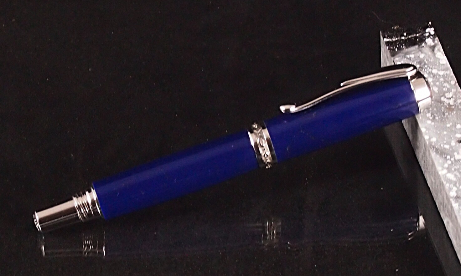

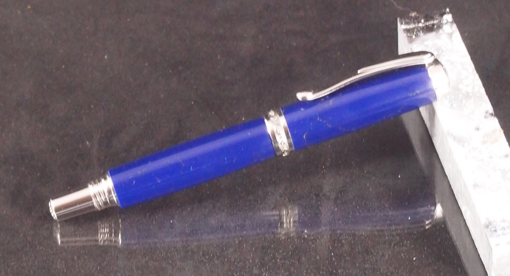

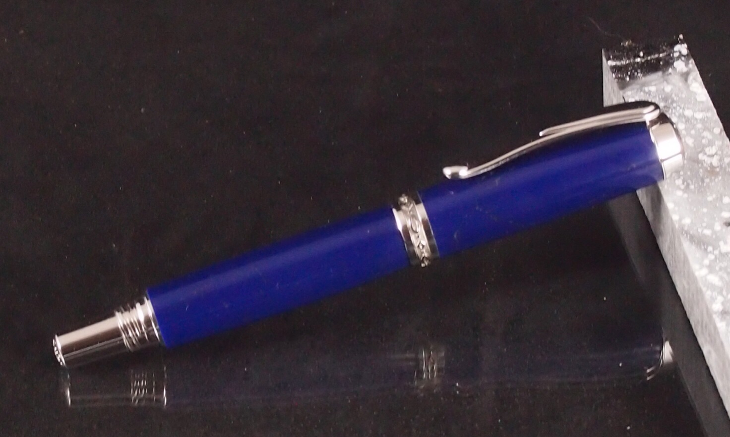

The photos are sometimes over exposed when the meter on my olympus indicates the exposure compensation value is 0.
Thanks

OK think of it this way. The camera sees everything as 18% grey. The standard of the photo industry. If your background is black the meter will see it as grey and give you an exposure that will appear overexposed because it sees the black as grey. Same with white. It will underexpose to try and make the white background grey. If you are in manual mode you have to compensate a couple of stops up or down to achieve correct exposure.
That helps and is consistent with what I just experienced.

Mark has it exactly right. The camera does not know that you have a black background. It's trying to make the picture average out to medium gray. Therefore, what it reports as neutral exposure is actually overexposed. If you want to continue using auto exposure, you can set exposure compensation (-1.75 or -2 stops from your photos). Or, you could switch to manual exposure (provided your camera supports it) and set the ISO, aperture, and shutter speed yourself.
