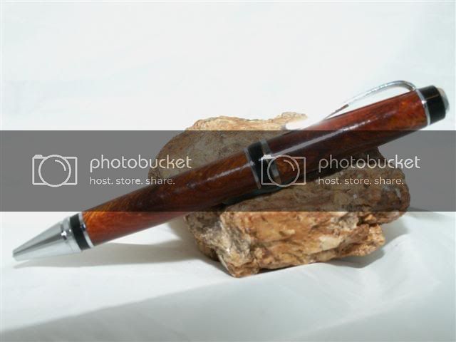

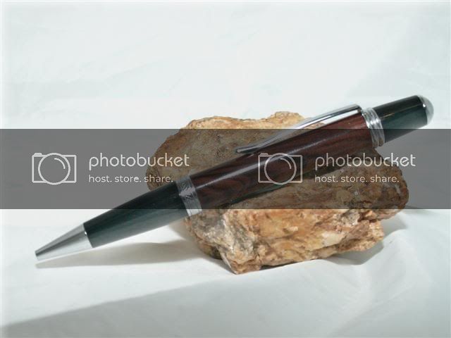

I am having no luck photographing a pen made from Desert Iron Wood and one from Morado wood. Both are quite dark woods. They have
exquiste grain and depth but it is not coming through in the pictures.
I have a light box,a couple of natural daylight photographers lights on tripods, a flash that is adjustable on my camera, etc. I have
tried it on macro, super macro, every flash and light configuration
I can think of and still no useable photo. If I point the lights
at the wood, it washes out the metal on the pens. If I filter the
light through the tent, it is too dark.
Here is the best I have gotten so far:
Any suggestions on what I am doing wrong? Normally I can take a pretty decent pic of a pen but these two are really giving me fits.
Any help would be appreciated.

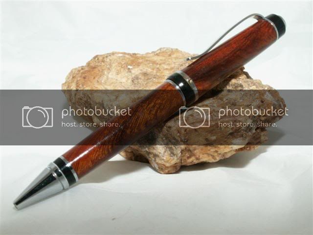

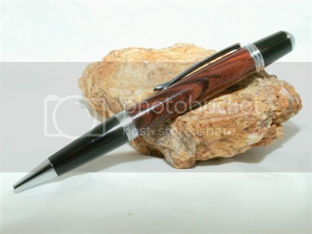

Ok...I think I figured this out. I increased the exposure +1.3 and here is what I got:
I think they are better...they look like the pens. You still can't distinguish the depth but it would take a pro to capture that.

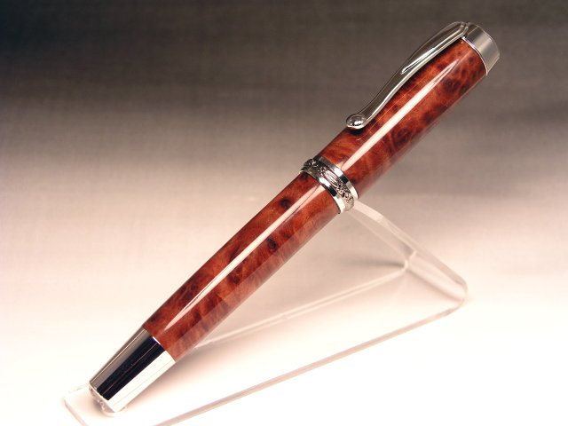

Digital cameras (Most Cameras) do not work well witht he stark white backgrounds. The camera sees the bright white background and usually adjusts the shutter speed (Reed CCD Digital Collection Speed)up, allowing in less light on the subject. This causes your dark woods to look darker.
A white to black gradient fade is really a great way to go. White at the bottom with varying shades of gray to top, fading to solid black.
Your second set of photos are much better, as the shutter (CCD) was forced to stay open longer (Speed slowed down). I usually take around 4-5 shots of the same pen in the same position with varying exposures. This is one from my album, but you get the idea:
Cheers,
Fangar
