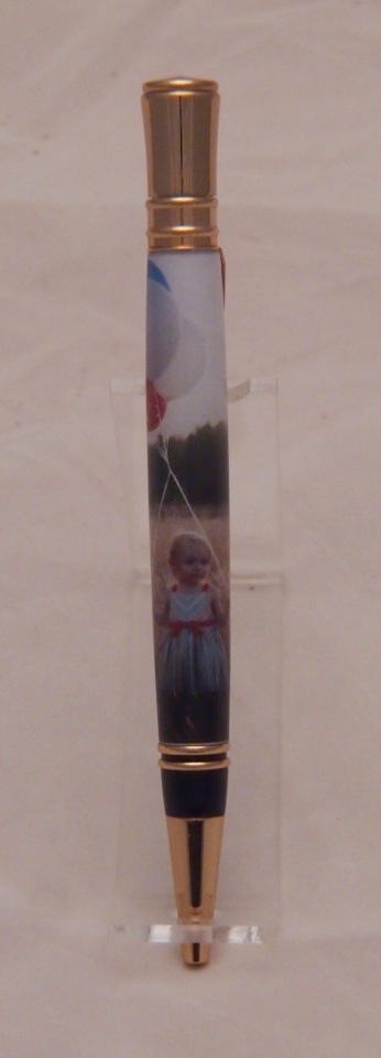

Coworker's granddaughter photo- in tube label cast on an executive.
Hard to get a clear picture of a picture on a pen.
Glorious Pen Cody.
What a Treasure, for both the Grandmother and Granddaughter.
How did you finish the Joint Seam of the Photograph?
Excellent choice of Kit, Superb Fit and Finish.
Great work.
Brian.
I use Don Ward's, aka "its Virgill", technique of adding a border to the image and letting the border overlap so that the edge blends into the seam.
Was wondering how you 'overcame' a seam with this one?
(If you wouldn't mind sharing, that is?)
Photo looks like it came out great...thumbs up!!
Scott (I get frustrated with the seam) B
On this one I used a white on white overlap and could not hide the seam completely. It is minimal but you still see the edge of he overlap. The best border for hiding the overlap is black, when using a black border color the cut edge of the overlap and becomes virtually invisible once you have a black n black overlap. You can use other colors if you can get a matching permanent marker to color the cut edged.
