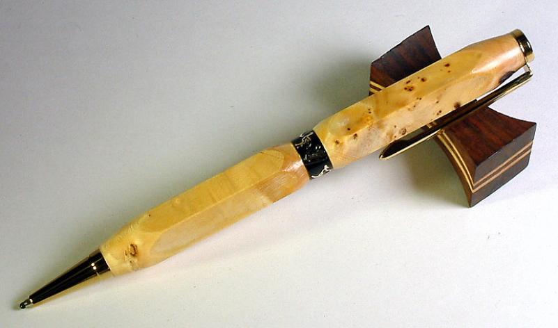

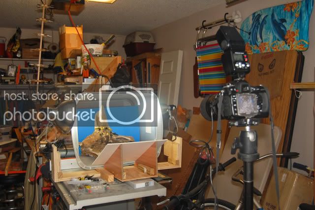

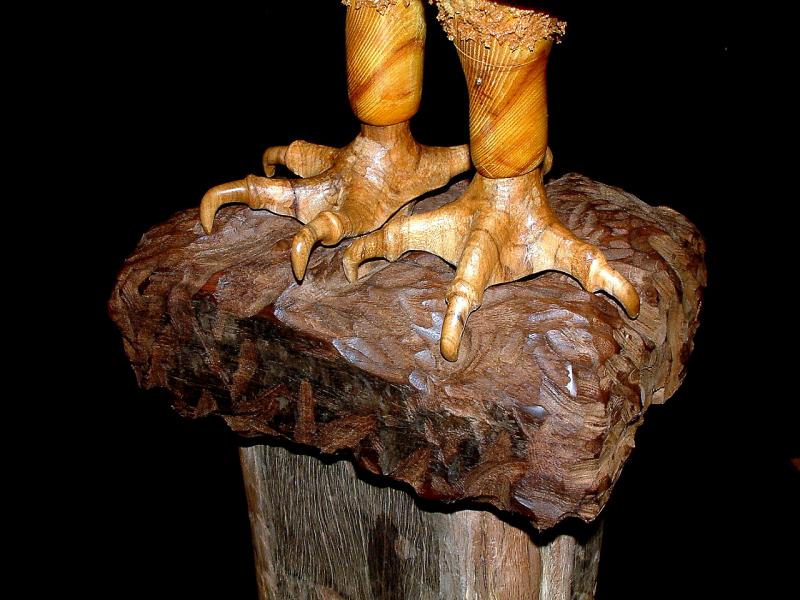

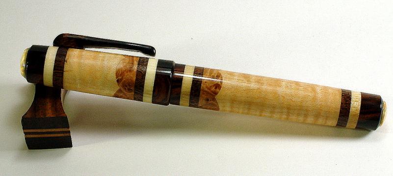

I opened a ream of 14 by 11 inches Photo Copying paper over ten years ago. Many thousands of pics later still have most of the ream left. I curve it up the eleven inch width section love it suits me. As a photographer for forty or fifty years my pen pics done simply to show the pens etc not seeking acadamy awards. Takes me about ten minutes to set up an open box made with a two inch block of foam board and conduit frame.

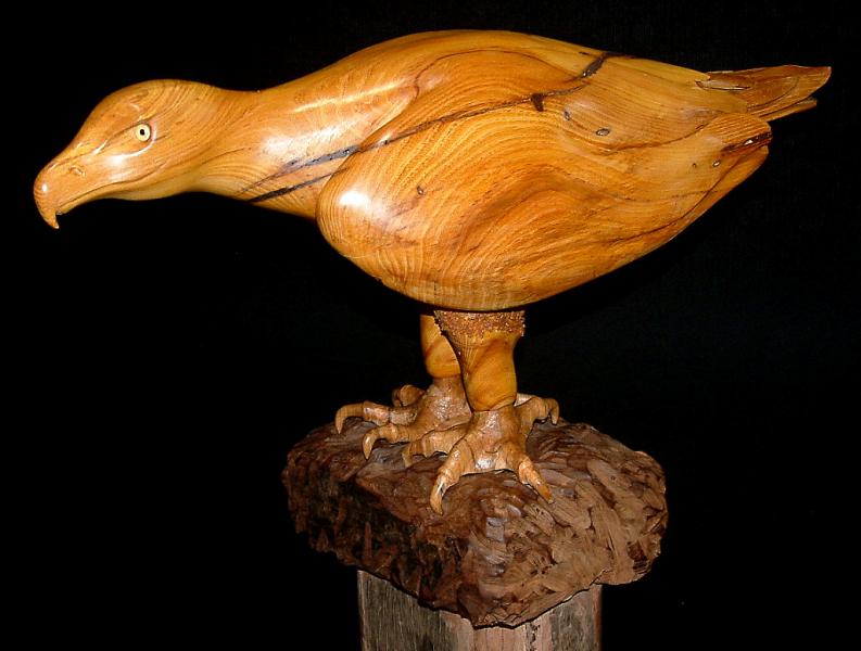

Hand held flash of the Bird at our recent Woodcraft Guild Exhibition by my mate and a care Gift by me using the open box.
Keeping it simple.
Kind regards Peter.

My open Box.
I use 1, 2, or three lights 47 watt 5000 kelvin Screw Fluros.
Kind regards Peter.

Thank you. I'm very curious about it, as a translucent box is what one usually sees recommended. What do you prefer about the open one?
Also, why a box? Why not just have the back support to attach the backdrop to, but leave off the frame pieces at the front and top?

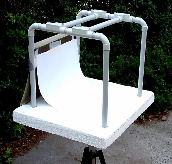

Matthew,
Being an old sparky conduit seemed the go it is not a casual construction having quite some strength and designed to support the top light, allow shooting down on an object as the pen is photographed also three sides to shoot from.
I have a bought so called box but it takes an incredible power in lighting to enable a decent aperture to be used.
It is light as to lift on top of a dresser in the lounge room, completely demountable joints not glued. You can buy cheap tube cutters used by Electricians or Sprinkler installers to clean cut conduit, also tees and elbows can be plain, another material thin plastic piping and fittings, the frame sits in the foam core section.
As a sixty plus year Photographer I had some old shades I converted as in the lit picture.

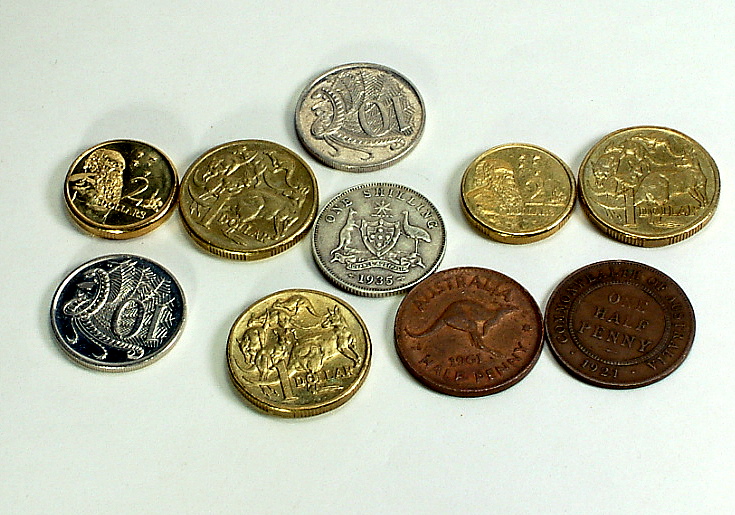

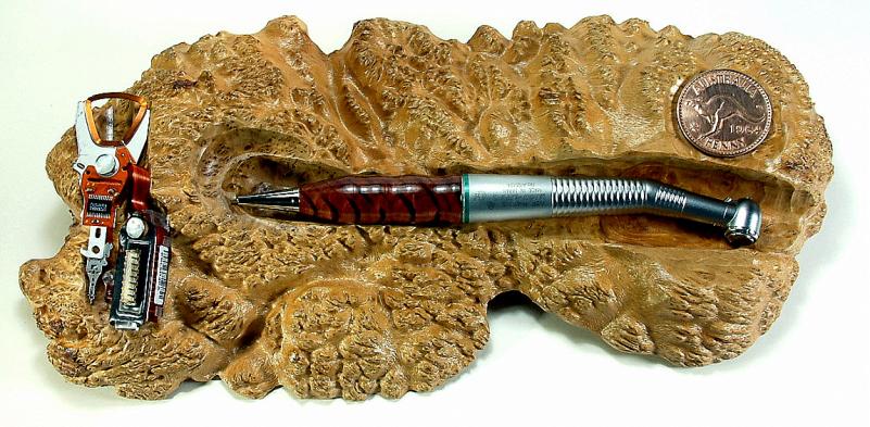

The versatility is multiplied when the background can be used in any position, I buy craft shop graduated backgrounds, felt squares, use sponged paint watercolour Portrait Heirloom self made background (sometimes called old master).
Be a master of simplicity and make whatever suits you examples attached.
Kind regards Peter.

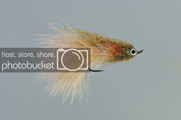

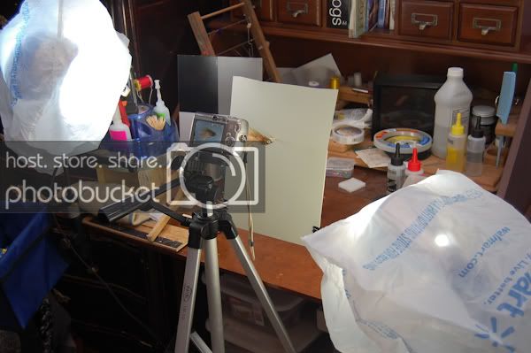

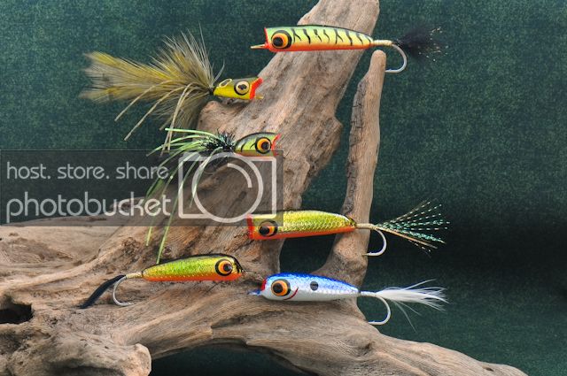

I haven't photographed pens yet but I've photographed plenty of flies and many have glossy finishes.
A large storage container works well to difuse the light for even shadows and with the camera on a tripod and cable release, the f-stop is irrelevant.
Another way is to put the diffuser on the light itself and just put your subject in the open. I found that plastic grocery bags work well for this.
I'm using the flour daylight bulbs and am satisfied with the results.

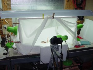

Oh, you don't need a fancy camera either, check out the setup with the bags on the light, it is a Point and Shoot set on manual mode and using the self timer to eliminate touching the shutter release and shaking the camera.
Kirk

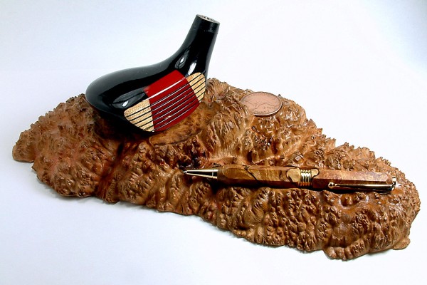

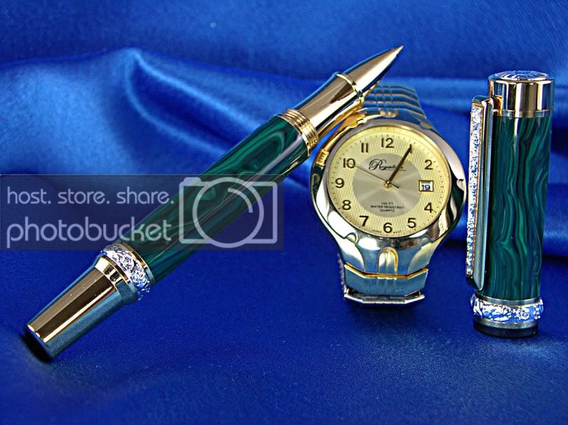

I know this isn't the pic that I took in the above set-up shot but I couldn't find that one, must have just shot it for my records but this one below was done the same way but with a cloth background.

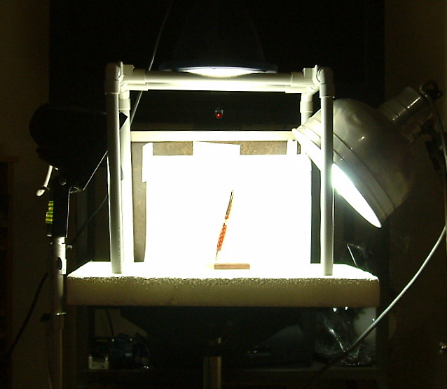

For my background, I simply snagged a dress shirt out of my closet that was close to neutral gray. A little darker, but it works for my needs quite well.
Here's a shot of my PVC-pipe framed setup before I started using the shirt. Also, I rarely use the light on top, but once in a while it comes in handy.
