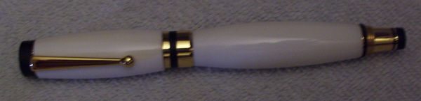

Finally decided to try another pen. Want something special to give as gifts. Arthritis was behaving, so here it is: Gold Phoenix with Corian. The Corian has gold color flowing through it. Was happy to get this variety.

John, your pen looks great. I haven't made a Phoenix yet, but I sure like its profile and construction. So, how is Corian to turn? Haven't tried that yet either.

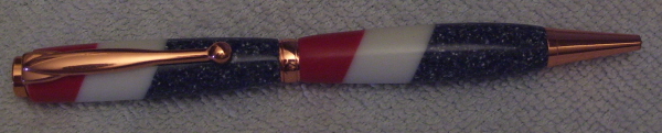

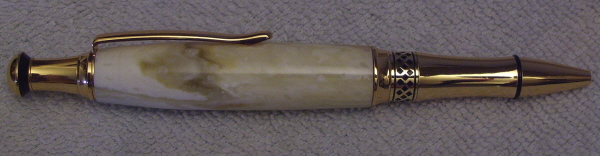

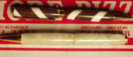

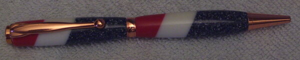

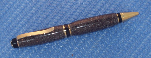

Here's a few that I've glued and turned. My photo album disappeared when they did a upgrade and I don't have the old pix on this computer. I had pages of pens.
