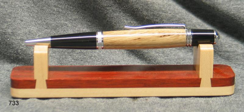

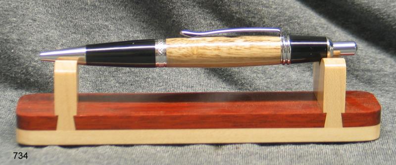

I did a couple and agree with others that the grain is not very interesting. I made them for sentimental value only (tree on our lot which was downed in an ice storm). The larger persimmon mallet shows a bit more character.
