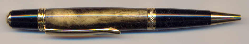

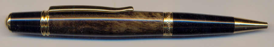

Here is a couple of pics of a persimmon heartwood. I flipped the pen over so you could see the side without the sapwood. There just isn't much heartwood. What I found out when I cut this last fall was that if I tightly packed the wet sawn blanks together, they all stained pretty dark. I have a bunch of blanks in a plastic bag hoping to repeat the process. Good luck!
