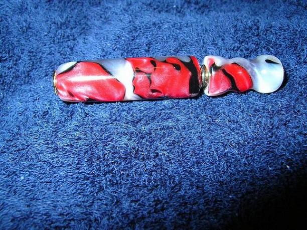

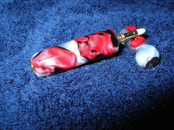

Thanks guys for all the comments. They were very helpful. I agree about gluing in the finials and such as this is something that you don't want to leak.
Alfred, if you don't mind me asking, what do you typically sell these for? I assume that you would be selling them cheaper to those who do the consignment and a bit more if you sell them directly. My wife is a teacher,so lots of women folk who use pens and such as well as being gift givers (you gotta love that teacher's heart). I had my wife take a couple of my acrylic pens to show her co-workers along with some photos of my work. She called me back at lunch and told me lots of people were asking about them as well as if I could different colors. So today I had her take in a display case that I had made for some knives years ago that I had hung on the wall of about 20 pens, along with the one perfume pen that I posted the photo of, to see what happens. So hopefully this will get me a little bit of cash to offset some of my start up costs (about $1500 over the last month for lathe, supplies and pen kits)as well as get me a few orders. I really like the concept of Valentines day and Mother's day stuff, so I will have to see about getting on that in a hurry.

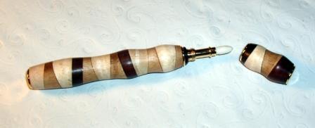

Originally posted by byounghusband
Here's on I made for my wife.....
NICE!
I really love the segmentation. I am anxious to try out some segmentations, but I have too many irons in the fire right now. But I'll get there...one day.

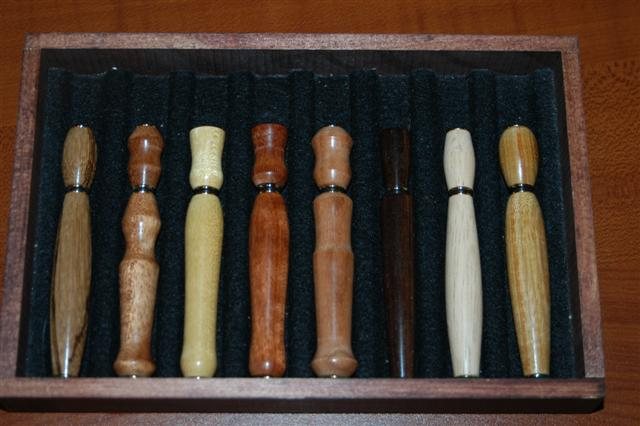

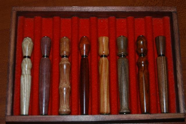

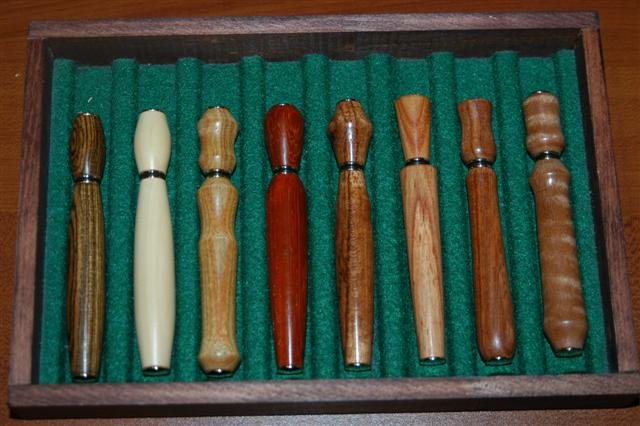

Yes, should had pointed you there instead of duplicatiing the answer. Note that i almost doubled my sales since then with the addition of the second hospital gift shop (125 sales during Hollidays season alone). Read the part about mens buying some too, i now have a display at the barbershop where i go.
Price is $20-25 with the velvet pouch. I sell them $15. no velvet pouch for 10 and more to the florist and gift shop, nothing to do exept delivery:D.
I used to do it at the beginning but I don't put them in concession anymore. Proof was made that they sell well and they simply buy them 2 dozen or more at the time. I always try to have 8 to 10 of those tray full in advance. I you want some tricks on production line, i'm getting pretty good at it :D;)
I also added some acrylics and crushed velvet to the line, they are killer.
Other place to explore, Hairdressing salon, beauty parlor, massage and spa, tanning salon. Just go in and offer the howner a free one to try. They become addict very fast:D
