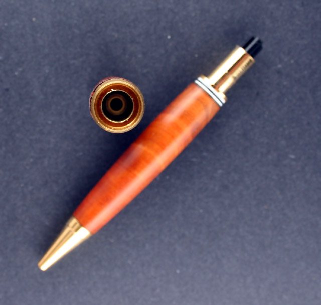

Ok, now I know I'm not the woodworker/metalworker/penmaker that many of you are, but why in the world would you think the transmission should be yanked out in order to replace the refill? It seems to me that the only logical design is for the transmission to remain in the upper barrel when you unscrew the two barrels. That way the refill simply slides out and a fresh one slides back into place, then the barrels are screwed back together. Here's a picture of how my Perfect Fits come apart.
<br />
Am I doing this wrong?
