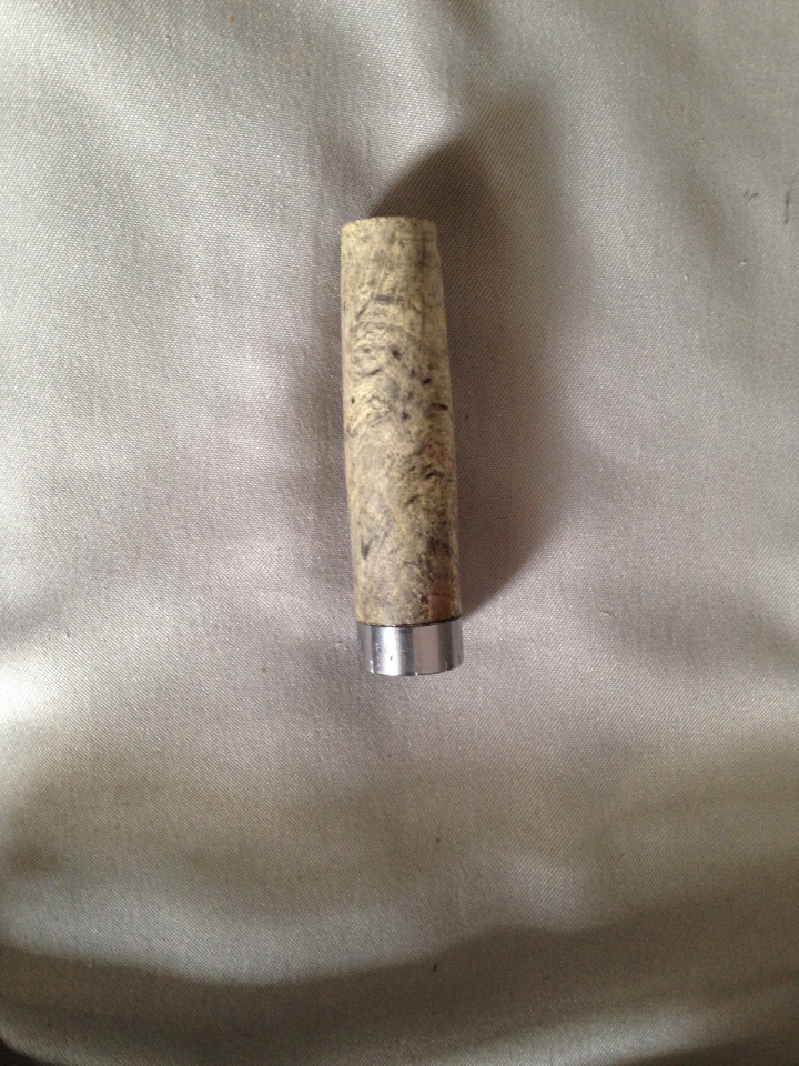

I just turned a PF and can't get the tenon bushing to come off the brass tube. Picture attached. I've tried gripping it with my hand and using pliers to try and twist it off, with no success. Any suggestions on how I can get it off without ruining the blank? I usually score the tube with abrasive tape before sliding the bushing on the tube prior to turning. This time I didn't. Lesson learned. Thanks.

My technique is to grip the bushing with pliers from the end and rock back and forth. Do it slow. Has always worked for me.

It is easy to get a small burr raised on the outside edge of the tube. Your abrasive process step rounds that edge over and avoids the burr. I put on the mag-eyes and use a sharp pointed exacto blade to scrape down the burr. Then it is easier to get back off.

I had the same problem--now when I turn off the material for the "tenon", I also use the parting tool to take off a little brass--makes the fit a little "looser".
