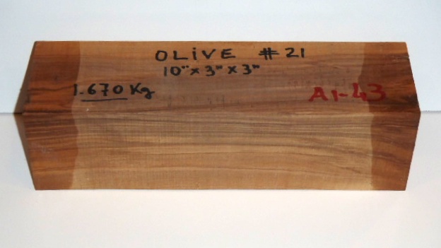

Contact George and he will cut to order Olive wood he has. He did some for us years ago, that at some point will be made into a Peppermill for our table. :rolleyes: No nut allergies to worry about, :smile: and reactions to Olive oil are uncommon according to Google.
Here is a picture of one of them.
attachment.php
