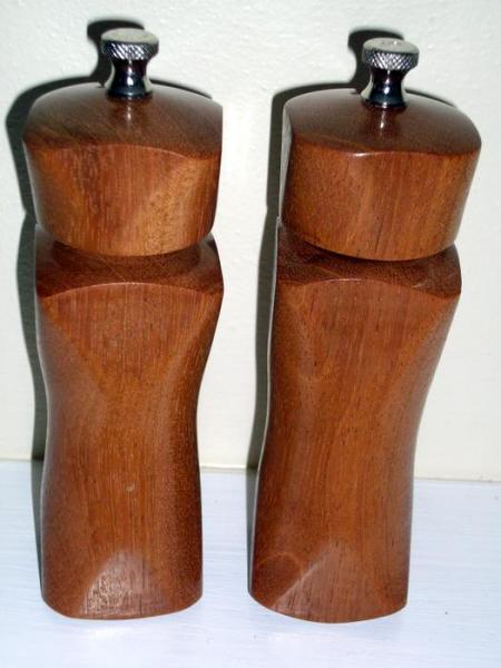

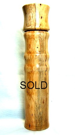

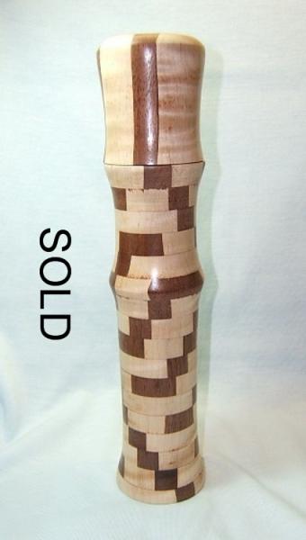

Three of these pepper mills were from blanks that were only 2.5. The one on the left of the group picture was even smaller.. probably more like 2 1/4. You will wind up with fairly thin walled pepper mills.
