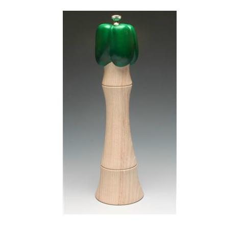

Must be the season for peppermills. Just got my Packard Woodworks mag and they showed some winners of their peppermill contest. I really thought the "pepper"mill was unique. Here is the link for more pics.http://www.woodcentral.com/contests/turning4/
