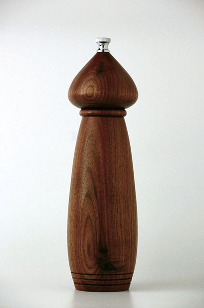

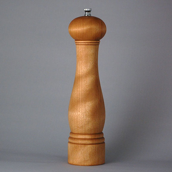

The 8" walnut peppermil has a 2" base. The 10" birch peppermill has a 2.5" base.

-Cory
