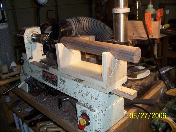

yeah 4 jaw chucks are a little rough. Take this with a grain of salt since I have only tried them once and it did not turn out. You can make a jig to drill on the lathe without a chuck.
<b>Image Insert:</b><br />
<br />
then I used a cheap face plate ( i got a couple small ones from PSI to make jigs)and turned a tapered plug to turn the body between centers so to speak.
the tapered plug fits into the drilled hole in the bottom of the mill and the live center goes into the top of the mill.
Note: I am not drilling a peppermill but a tool handle in the picture but the same idea should work but I would suggest secureing the wood better to use a large fostner bit.
Is that a custom paint job on your Jet, Mike?[:D]

Yeah I call it walnut fleck [:D][:D]
Mine were not the crush mills but the tapered plug I made looks very much like the ones pictured in the link Gerry posted.
