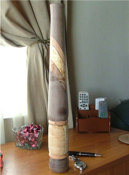

OK, Daniel. I have a couple of questions now that we have a picture.
First off, how tall is the pepper grinder and what is its maximum diameter?
It appears that the joint between the cap and the body (where the twisting occurs) is about 3/4 of the way down from the top where the dark and the light wood meet. Is that upper section drilled out so it can hold peppercorns or is it solid?
Even if the upper section is hollowed out, it must still weigh a ton!! Do you know how much it actually weighs?
And finally, what type of grinder mechanism did you use?
It is sort of an unusual design for a peppermill; but I think when it is finished up, it will make an attractive piece.
Randy, The top knob is not on it yet but will be a traditional looking top (seems I have misplaced that piece of wood[:I]). The mill will be 24 Inches tall when finished. max. dia. is 3-1/8 inches, originaly planned to be 3-1/2
So far it weighs about 1 and a half pounds (No pepper corns). and the parts came from CSUSA. There stainless steel Deluxe version.
I made this one as a part of a complete set for display. I don't think we will actually be using it. would be fun for Christmas eve at my parents. But the real market I see for it is in restaurants. Being in Reno there are several that like to make a show of your meal. They will use grinders of this size so that the waiter or waitress can reach across the table to put pepper on your salad etc. I will have to try again to get a good 24" display though.
This one is anything but great work but I learned a ton in the process. most of my joints show gaps, I actually had to fill a bunch of voids and tear outs,and there are a few placed that I had to glue several small pieces of wood together to make a large enough block. I will not try this again with anything less than 3-1/2 by 3-1/2 stock and that is with planning for the grinder to be 3 to 3-1/8 diameter. I think now that 3-1/2 would be to large. this one is already a hand full but comfortable.
