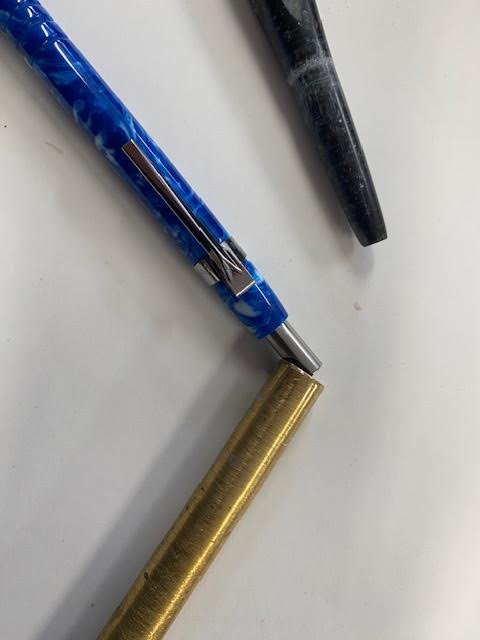

I take a spare pen tube that just fits over finished pencil and put the clip on it.
Then place the tube with the clip on it on the pencil to where I want it and slip it off.

Here's a few pics to explain

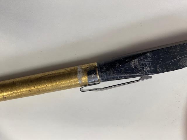

I turned a piece of corian with a taper to help get clip on tube

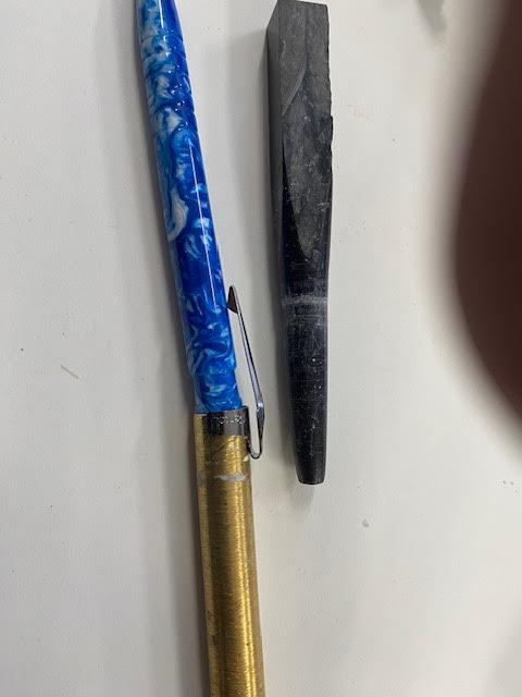

Slip it over pencil and slip off
Hope this helps
