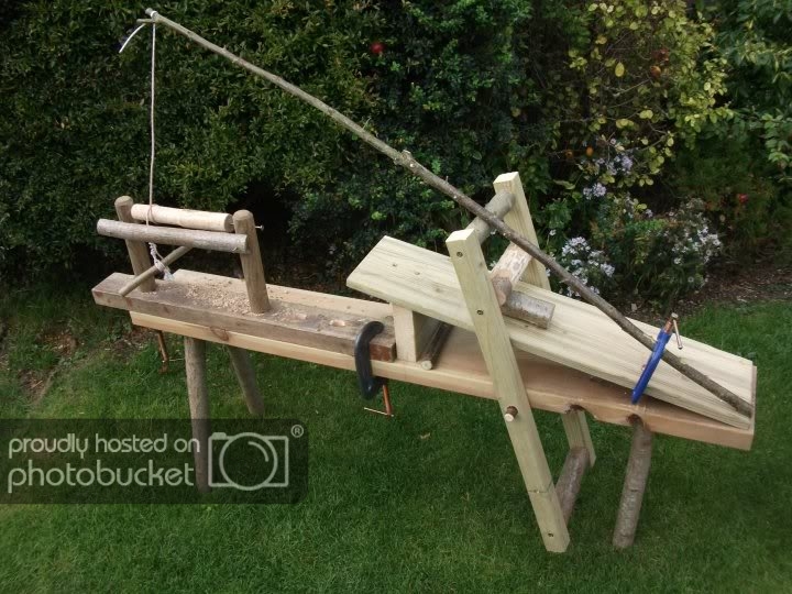

Got any green twigs lying around? :)
http://www.instructables.com/id/A-modern-build-of-a-medieval-spring-pole-lathe/
