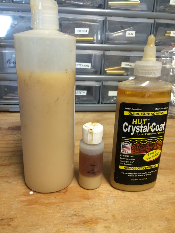

This picture illustrates one difference between pens plus on the left and other common friction polishes.
The little one in the middle is mylands and the right is hut crystal coat.

One different that I was trying to illustrate is that pens plus doesn't separate. Look closely at the other two.
And yet the bottle is still marked "Shake Well". That implies to me that the "non-separating" is more apparant then real.
Dan, if not mistaken directions for all three products in your comparison require you to shake not stir before use! Just because do not see separation with Pen Plus, what does it mean.
Except for product contents advertisement hype sounds the same. If not mistaken Crystal coat might be least expensive product.
