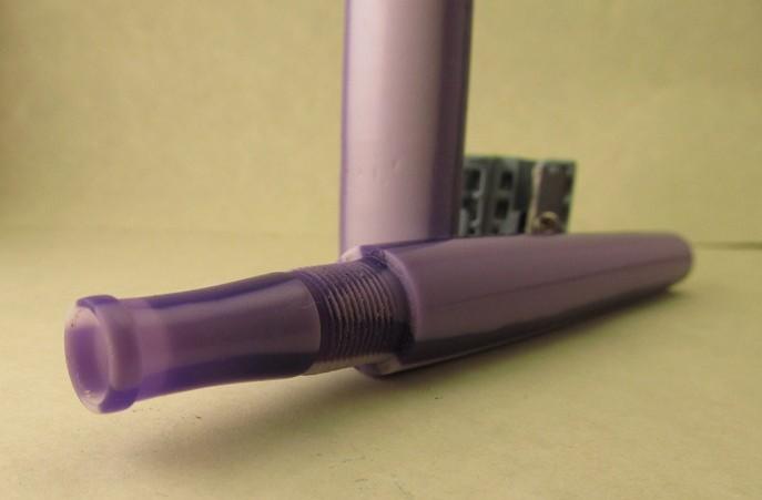

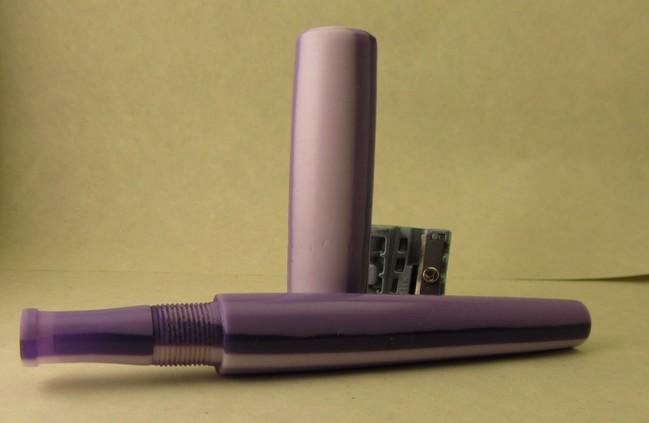

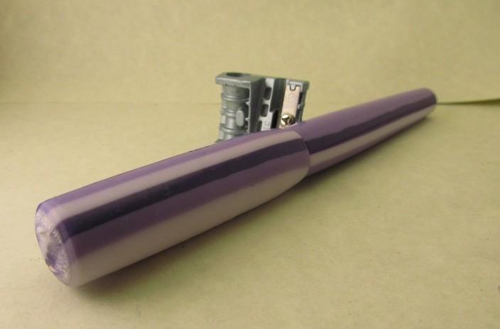

Here's 4 and 5.

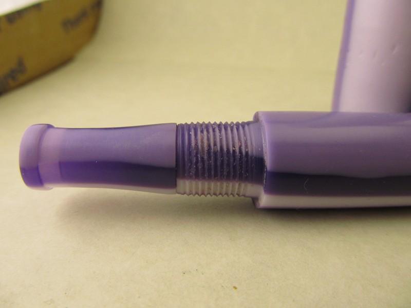

THe purple stripey thing --- yeah. An absolute mess. Nothing I'm proud of, but I learned something in the process. I made the section first. Won't do that again. Section is too skinny - barrel too long. If I had larger tap and die for the barrel to cap threads The barrel length would be okay...
I haven't even put a nib in it to see how it would balance. It's just too ugly.
Seriously though - the problem with these purple blanks was the condition they were in when I got them. They were bent - or curved. Awful to work with. I used a small pipe torch to heat the blank when it was in the 4 jaw and bent it down a bit using some channel locks. Didn't work too great - but helped a little bit.

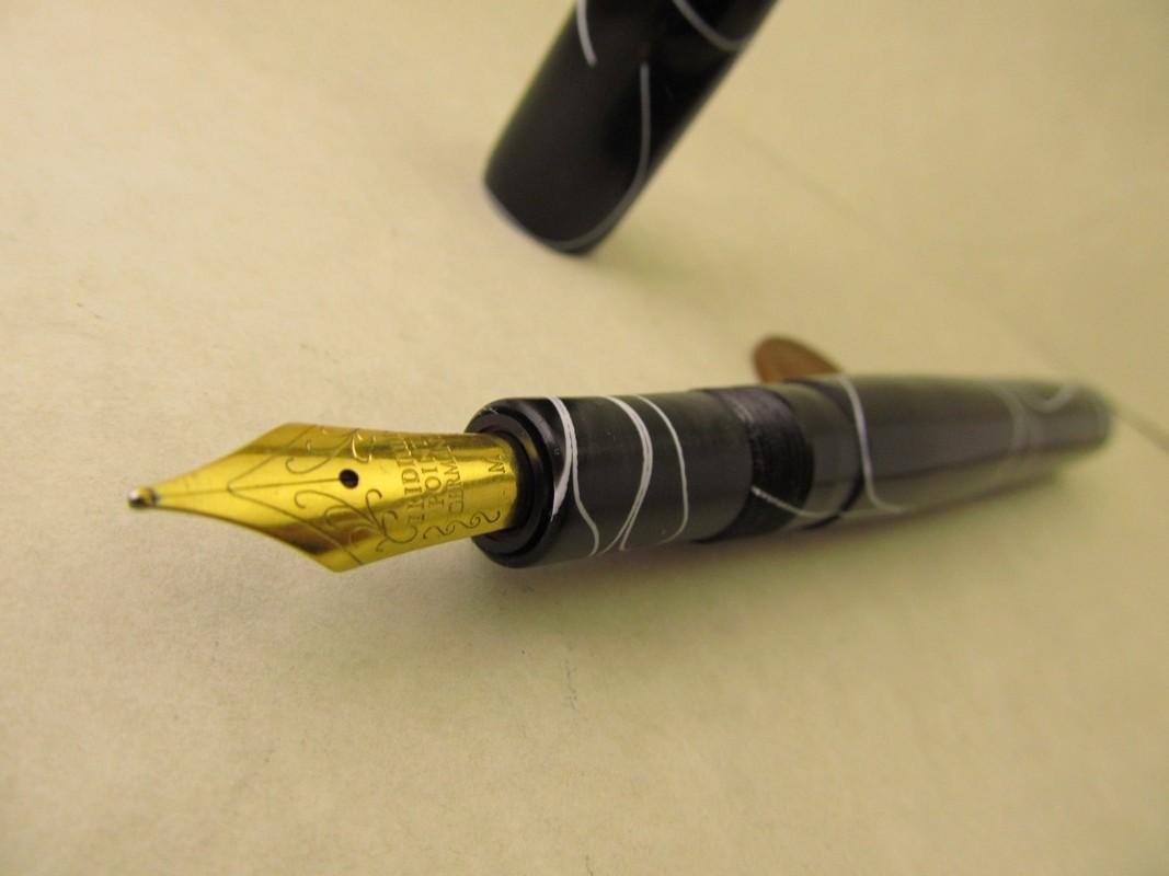

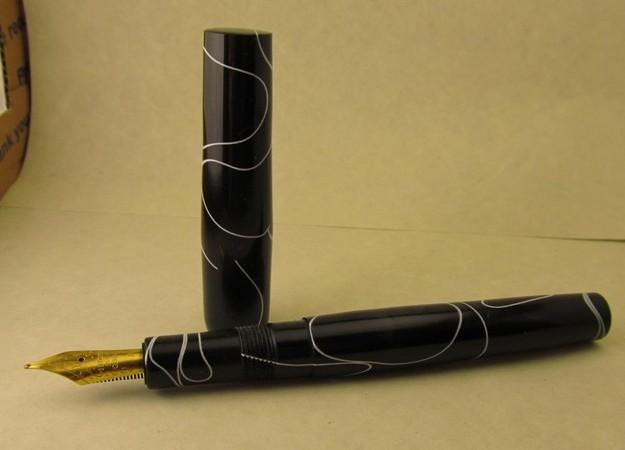

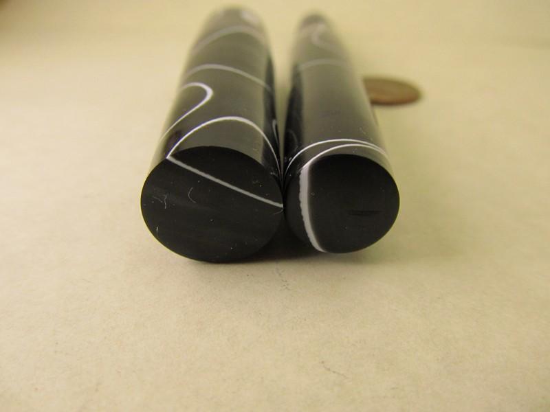

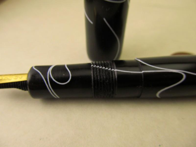

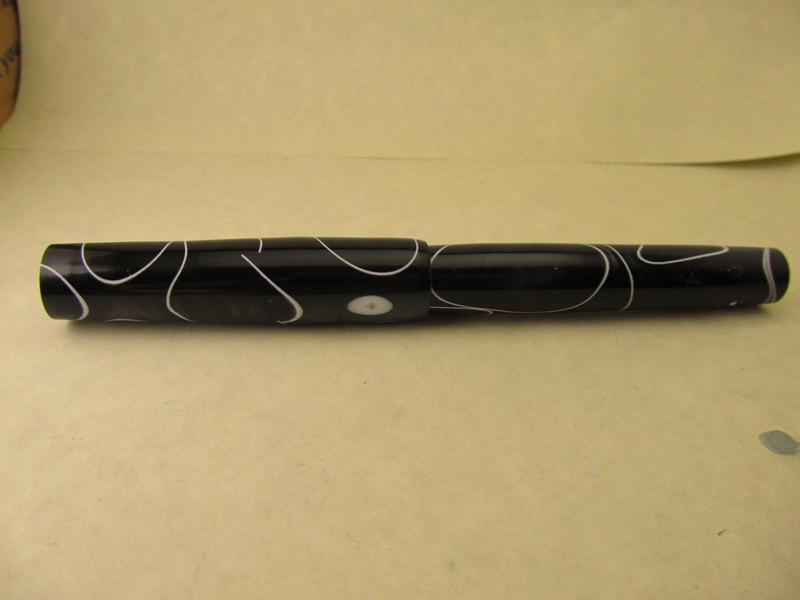

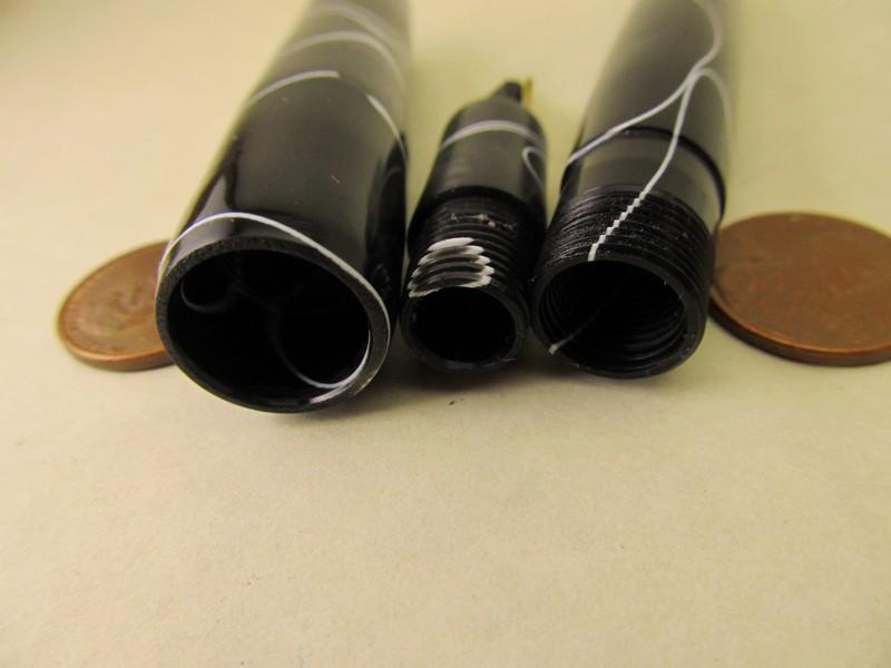

And pen 5.
I like this one pretty good. The cap walls should have been thinner. I also didn't clean up the cap lip like I should have. I'm tired though. Gimme a break.
I did spend more time with sanding through micromesh so the finish is better than my other pens.

Somebody just offered to BUY the ugly one! I can't believe it! I even told him it wasn't finished, but if he really likes it, I'll finish it up and he can have it for the cost of the nib.
THe purple one... oh boy. Yeah - somebody just bought it. :/
I even explained to him why it wasn't any good and why it's awful and why he shouldn't want it...
He wants to use it with India ink to sign school awards on shiny paper (he's the art teacher and automatically the one who has to write the names in pretty italic script). I told him he'd have to clean it good after each use or it would be garbage. He knows. But this was his favorite... my mom also REALLY liked it.
