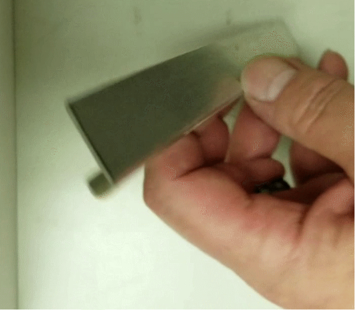

Ok, I'll bite....what a stripper?
Basically something to make strips of sandpaper with. Not sure if the other poster has a special tool or not, but here is mine. (did you think i was going to post something else ? :angel: )
