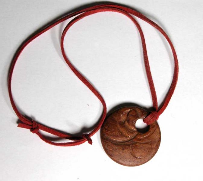

Here are the tools I like to use:
- 5/8" bowl gouge to go from square to round (with tailstock support)
- 3/8" spindle gouge pulled towards me making shearing cuts to dome the front of the pendant.
- 3/8" spindle gouge pushed towards the center to enlarge the offset hole (or create an offset dished surface)
- skew to round the outside edge (used like a scraper)
Some examples:

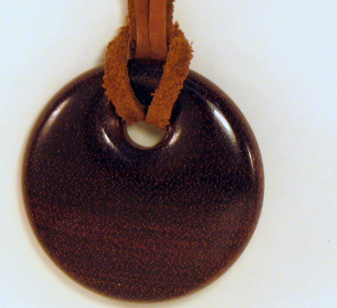

Bree, I use a woodchuck with a 2 inch radius insert, (but a skew will also work) with my wood mounted to a scrap of Melamine and taped with the DUCK BRAND double sided tape from Walmart,:good: on one of the deluxe pendant backer plates. I've only done a few, but haven't had any come loose yet :smile: I find that just using one tool makes things easier.
I must confess that I do use a parting tool to get the pendant free from the backing plate so I guess I use two tools, also a parting tool or skew would work well for detail cuts as long as they were sharp.
