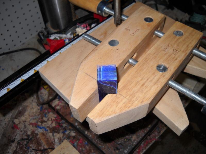

I haven't bought a pen blank vice yet. Too many other things going on that are clammering for the money in my pocket. So I took one of the el-cheapo 8" handscrews from Harbor Freight ($3 after a coupon) and cut a "V" in each jaw. You can dis-assemble the handscrew which makes this cut much easier. I just used a handsaw but a bandsaw, jig saw or scroll saw could do this too.
The jaws of a handscrew will self-align so this has worked great for round blanks, square ones (such as acrylic) and no-so-square ones cut from larger lumber stock.
You don't get the automatic centering of a real pen blank vice but for the money it works well. The next cheapest to use some scrap 3/4" plywood and make a small right-angle fence and base that you clamp to your drill press table. But I'm not keen on hand-holding small pieces for drilling so I went this route.
