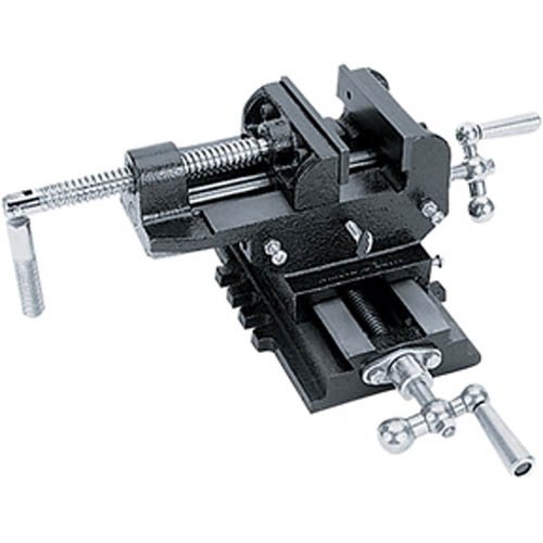

I use a machinists cross slide vise from Grizzly. Has many uses. I am particularly fond of the safety factor. Holds stuff while hands are kept away from sharp turning things. It has one groove for the corner of a blank, I scratched a corresponding mark on the opposite jaw. Works well for me.
