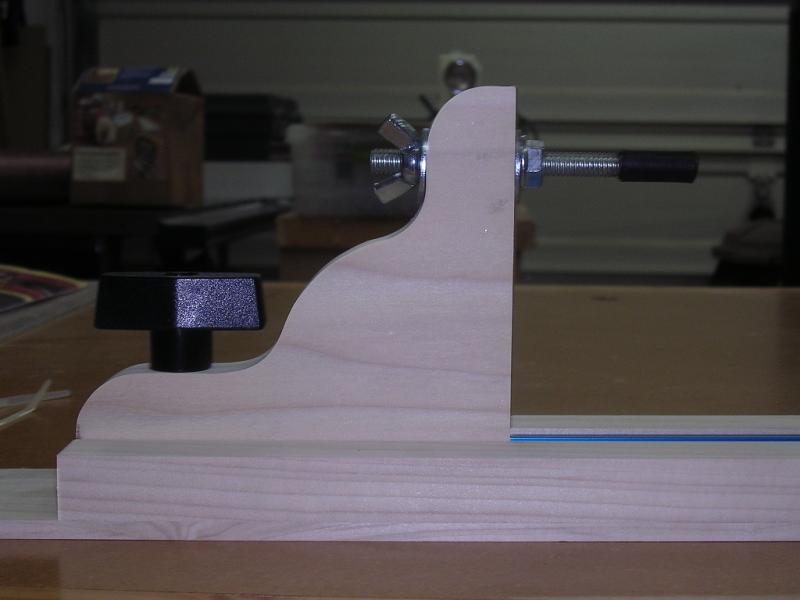

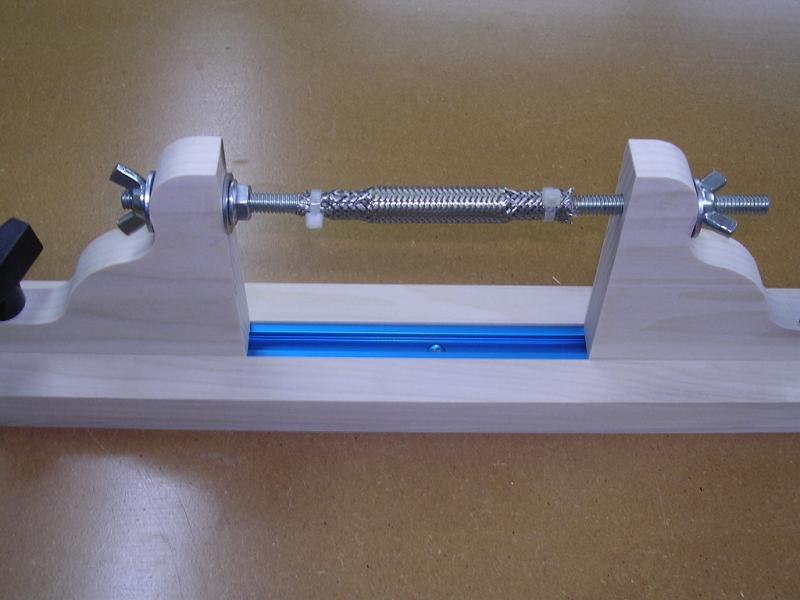

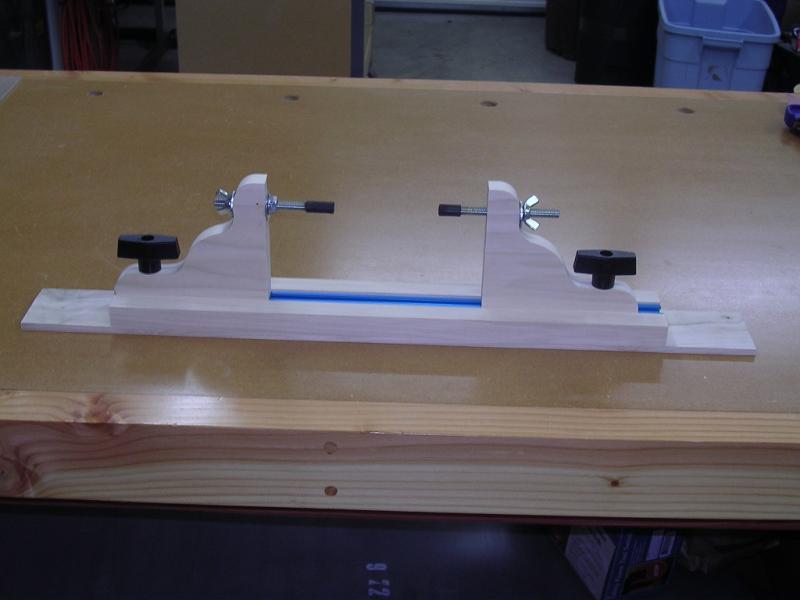

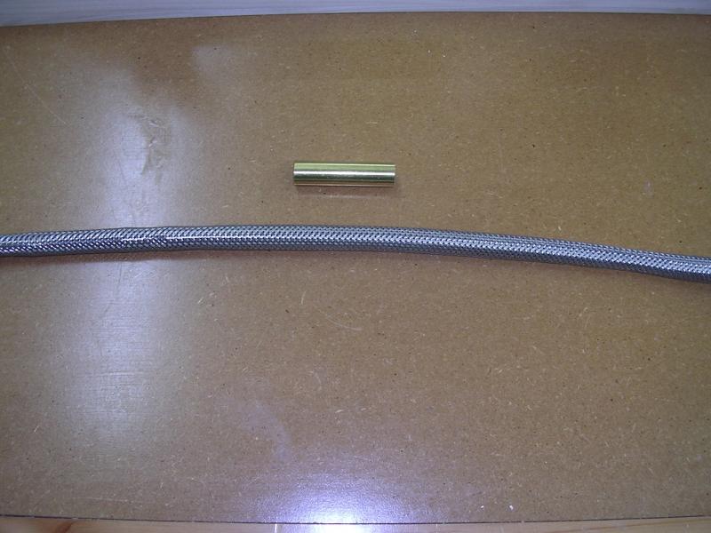

Designed and built for stretching braided covering over pen tubes.
This fixture holds and stretches the braid. It's adjustable for any length tube. It also can be used to support a tube for applying a decal, feathers or anything else you wish to apply to the tube.

Mike, thanks for sharing. I have a contraption that consists blocks of wood and vise grip - real ugly. Your design is much superior.
Thanks Randy, Chris & PenI8the. After all the info and help this websites members have given me I'm only too happy to make a small contribution.
Nice one. Would that be of any help doing the snake skins? I've never tries any but it looks to me like it would somehow help...
Mike,
That is a very good plan, simple and easy to use. Right up my alley:biggrin:.
I've done a couple braided castings. While they worked ok I certainly ended up with alot of waste and a mess. Love those T-tracks, very useful item.
Thanks for sharing.
Carl
Mike, thanks for sharing you wonderful invention. That is exactly what this site is all about, when one finds a better way, then sharing it with everyone else freely. That is one very helpful and elegant device. Simplicity with functionality. Great job.
