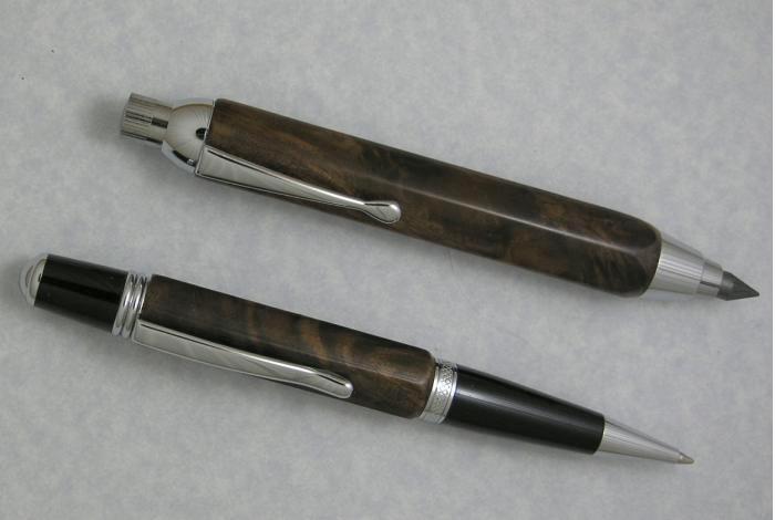

A polygon having five sides and five interior angles. These are Walnut.

Nice Chuckie, I really like the pencil.
I have been making pencils tonight like everybody else,
I just might slab one now after seeing yours [:p]

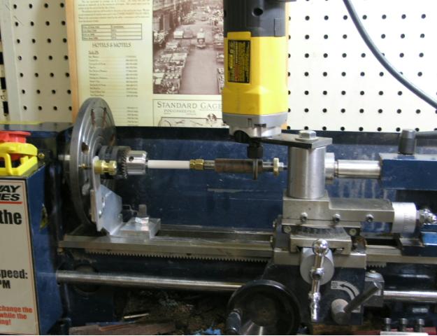

gerryr - will your pen mill do any number of sides? As long as you are able to index the cutter to the work any number of sides would be possible.
Rifleman - Which kit is that? CSU Artist Pencil
OSCAR15 - How did you do that? and
chigdon - Also what wondering what kind of mill you are using? Here is a picture of the set up I used on these. I also have a mount for a Dremel tool but the lamanite trimmer provides much more power to the cutter.

Originally posted by Mudder
<br />Do you use that lathe for turning all of your pens?
No. At last count I have five lathes so I just choose the one best suited for what I am turning though I often put a long 1/2 inch bar in the tool post on this one and use it as a tool rest when using woodturning tools. I do use this one for pens with flats, flutes, spirals, or grooves.
