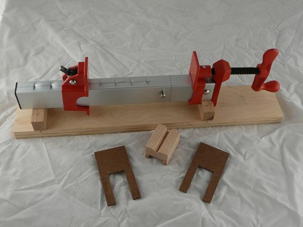

I made this pen press some time ago and it has worked great for me. The clamp is from HF. I don't remember where I first saw the idea.

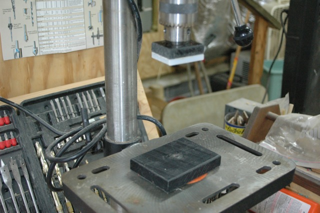

I finally got around to making one. I'll take a pic when I think of it. It works pretty good, but the best one I had was my drill press, with a small round of Delrin that I put in the chuck. Had another round of Delrin epoxied to a block of wood that sat on the drill press table. Only reason I quit using it was because of the constant changing over from drill vice to pen press.
