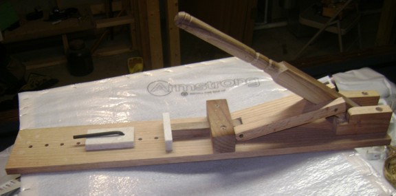

I have some plans for this.

This may sound crazy, I use a can crusher that I bought at Harbor Freight. I cut two pieces of Corian countertop and rivoted one to each side of the jaws. It works well You can get your hands through the handle and position the pen and parts in just the right place. All in all I have about six bucks in my customized pen press. By the way I did build a stand that I mounted on my bench to mount the press to. I am not sure I could buy one that I would like better.
I made one out of a nut cracker. It was to close so I cut it in 1/2 with a chop saw, and mounted it on a1x8 pine board , ran a grove along the side to hold the pen and parts, then cut two blocks, and knoched them to slide over the metal. works ok for me, but I also bought a Arbor press from H F because I was braking pens , tring to get the cap through the clip ring.

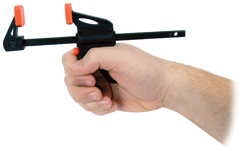

I installed leather strapping over the tops of the soft plastic jaws and simply am able to slowly squeeze it all together. So far 80 Pens later and All good. No cracks / misalignments.

I'm using a clamp with a squeeze trigger. It works pretty good. I have had a couple pens that have been difficult to keep completely straight while pressing the parts together. I'm thinking of making a press block to hold the components while pressing them. Any ideas on that?
