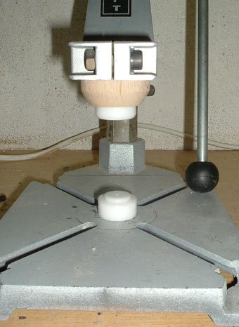

i made a press myself. I had an old drillmachineholder ( sorry, dont know the correct english word)and turned two pieces of POM (plastic).The clamp (?)of the machineholder was too big, so i glued the POM into a piece of wood.
I am happy, this tool works fine, and i hope you did understand me...

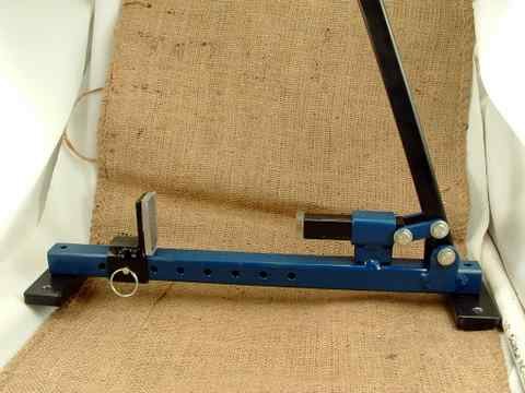

If you are patient one of the members on here makes a killer pen press. Check with Paul in OK PHDesigns. You may have to wait 6 months but from what I am told it is well worth it. I think I still have three more months to wait for mine. [:p]
Originally posted by MLKWoodWorking
<br />If you are patient one of the members on here makes a killer pen press. Check with Paul in OK PHDesigns. You may have to wait 6 months but from what I am told it is well worth it. I think I still have three more months to wait for mine. [:p]
Here is a picture of Pauls press, well worth the wait.

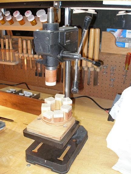

I used to use my drill press. Bought a 1/2" hex head bolt and epoxied a hardwood scrap to it and chucked it in the DP. You don't even need to do that, though. You can take a scrap piece of hardwood and turn it round on your lathe so it will fit in your drill chuck.
Changing the "ram" in and out of the DP got to be an annoyance so I built my own press. You can see pictures of it in my photo gallery.
