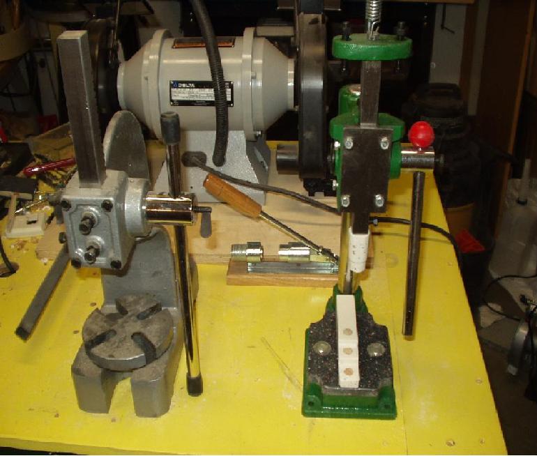

Eagle showed one photo, here's another... This shows the press before modifying and adding the turret adjustment. Also shows 1/2 ton Arbor Press from Grizzly and my "nut cracker" press. I've used clamps, bench vise, woodworkers vise, drill press and finally the nut cracker, Arbor Press and then this new press. Eagle was inspiration for some of the Mods. The ram is a 3/8" bolt cut off and embedded in Corian, the turned to shape. Poly Glue. Put Glue on threads and into Corian, clamped it overnight.

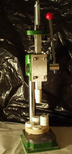

Finally, I use one press, this one, set-up to "Automatically" size, thanks to Eagle's suggestions. I merely "beat him to it"...
That's a Corian Base Plate on the press, tapped and threaded for a bolt as the pivot for the turret. The Arbor Press is due to get a "New" turret as well. Stay tuned...
