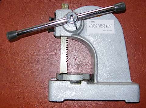

You know that old saying "You don't use an elephant gun to kill a ____"? I think it is squirrel, or something like that. Anyway, it may be overkill, but this 1/2 ton arbor press is awesome as a pen press, costs about $10.00 less and has more uses than a pen press. It does weigh about 20 pounds though. $30.00 at HF.

When the pen is longer than this will accomodate, take off the metal disc, then bolt the press to the table, it will then allow your table top to be the "bottom plate" and handle all sizes of pens.
Also, you CAN replace the metal base with a corian substitute and drill holes to accomodate the different collars in pen kits, so you don't put pressure on the threads that will hold your transmissions.
Oh, I have one, thanks![:0]

That's some good info. I've been using a pipe clamp and it doesn't have a flat stand, so it rocks and was a real pain. This press did a great job, with no messing around with balance. I'll be on the look-out for some corian.

Look at the vertical ram, see if it can be inserted upside-down, giving you more vertical travel. I think that's what I changed-its on my demo lathe, so its packed away-the ram comes out easily, set screw.
I know mine now does a slimline, but I do have a hole in the corian that adds about a quarter inch.

Originally posted by ed4copies
<br />Rob, Look at the vertical ram, see if it can be inserted upside-down, giving you more vertical travel.....
It looks to me like you could cut off about an inch of the end of the ram and get some more capacity out of the press??

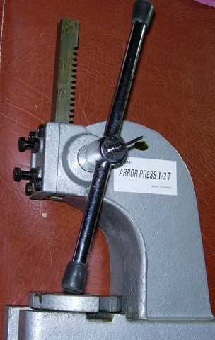

Here is a pic with the ram retracted all of the way. It actually goes into the housing a little. I think that I will bolt it to a base, like I mentioned, then replace the table with a softer material, like corian. I don't intend to turn a whole lot of different pens, so I won't have to drill too many holes in it. I thought of capping the plunger (ram) with something softer also. I don't want to chip the plating either.

Well, seeing that picture makes it obvious that my idea won't work. [:I][:I] Just out of curiosity, what is the distance between the top of that plate and the bottom of the ran when fully retracted??

Two options or a cobination of both.
Cut the ram shorter and/or build a sub-base the thickness you want to raise it.
drill through the casring and bolt the press to the base.
YOu will want a "sweet- spot" where the handel exerts the most amount of force while press yet doesn't require a lot of effort to do the job

Thanks for the ideas. The ram is already short enough, as it disappears into the housing. There are already holes drilled for mounting, but your idea for making it as thick as the distance I want to raise it, is also good. I have plenty of plain stock (2" thick oak planks) too.

Cutting the ram, I posted about last night......building a sub base occurred to me while in the shower this morning. Apparently we came up with the same solutions; but not in the same sequence. Already established that cutting the ram isn't such a hot idea; but building a sub-base should work very well!!
