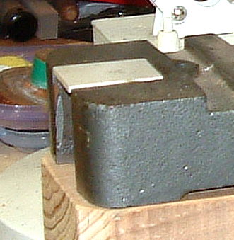

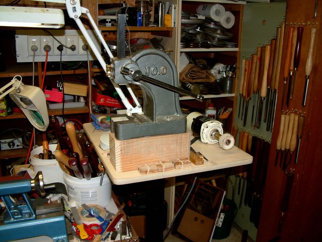

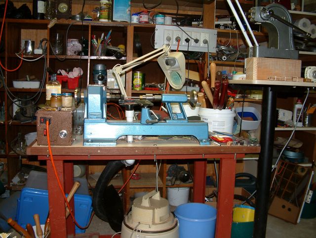

I enclose pics to help my explanation.
1. Chuck the Anvil piece under the press arm, fit an Aluminium solid just below the surface drilled and bolted from one side the one you cant see now.and glue a piece of thin Corian on top. Try to maintain the largest gap possible some things are longer than others and size does matter.
2. Check the flatness of the compressing arm on mine it was out so I reversed it was out so now flat, take it off and prepare then glue thin Corian on the pressing face.Reassemble.
3. Mount it so you can eye ball the two verticals in my case you will notice I gave it a wooden platform. I choose to sit at my workbench, welded and designed just fror me.
Although now 76 no I dont need to but choose to. Alongside on the small table is a variable speed buffer. So after finishing I assemble the pens seated as well.
Have success has served me well for many many years.
REgards Peter.
