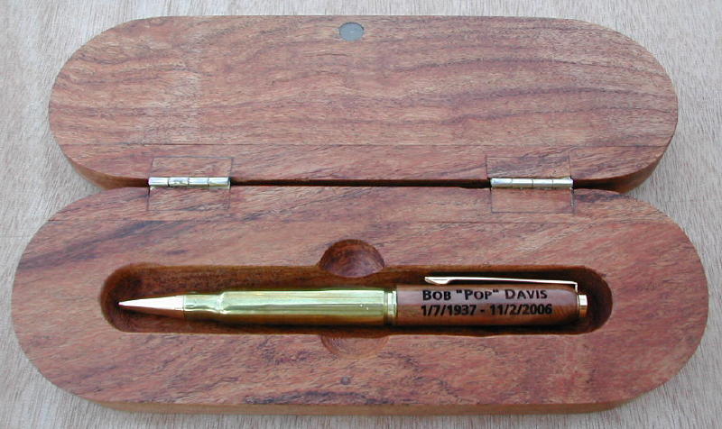

I have been working on these for a very good friend of mine. His father passed away in November. As his Father was an Army veteran he was given a gun salute. My friend asked if I could make him and his brother a pen out of the spent cartridges. This is what I came up with. His Father was a life long Texan so I wanted to use a native Texas wood, mesquite.

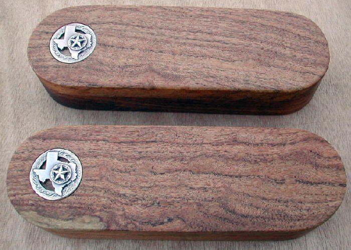

I had their Fathers name and his birth and death dates laser engraved in the pen and in the top of the box I inlayed a Texas concho.

Wonderful work. If I may ask, how was the building of the pen box done? I sometimes will want to build a box similar to that of yours, of the same woods that my pens are made of. I see a glue line on the inside of the box, but can't imagine the reason for it, as I don't see the same line on the outside of the box. Also you've hidden the hinge plates (for lack of the correct word), again, how'd you do this.
Thanks for the comments fellows, they are appreciated.
Anthony, the pen boxes presented the greatest challenge. While they came out OK, they had to be modified at the last minute. I started out trying to make it using the small barrel hinges and forty-fiving the edge. But I never could get the lid to open properly. I had never made a box using those type of hinges and I wasn't 100% sure how much 45 I needed. Anyway, I ended up cutting out the 45 and glueing in a filler as I did not want to waste the work I had already done. I tried to match the grain as best as I could. Also you are correct about hiding the hinges. I recessed the plate of the hinge enough that I could glue a thin piece of mesquite over it, again trying to match the grain as close as possible, and sand it smooth.
