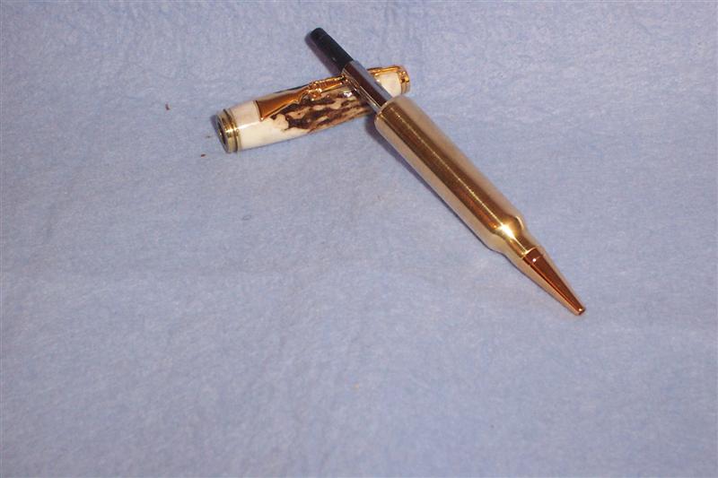

Originally posted by coach
<br />eaglesc,
Would you let me know how to make one of those? What caliber casing and how do you make it work? I have to make myself one of those!! Thanks!
Coach-
Please don't misunderstand how I word this.
The antler part is easy,but the casing part the way I do it is more difficult than the way others have done it.
Check some posts by lower 48.
There's different ways to do different things to get the same end result.
I've only been making pens sice june 05 and I have been wanting to make a casing pen for a while.I used a thought process to work out each stumbling block as I came upon it.
Sor far the results are decent but the meathod needs to be improved.
These would be a lot esier if I had a machine lathe.
I would not attempt to make one the way I do after 8 slimlines.
That being said if you really want to make one using the meathod I do you'll figure most of it out yourself, and if you hit a wall,I MAY be able to answer some questions.
I am by no means any kind of a pen GURU.
I just attempt to solve problems as they come up once I get an idea or design.
I will tell you a 30-06 or 300 magnum is a good fit for a slim line nib.
At least that's what I have forund so far , htere may be others.
THose are what I have scrounged up.
I don't know anything about firearms.
