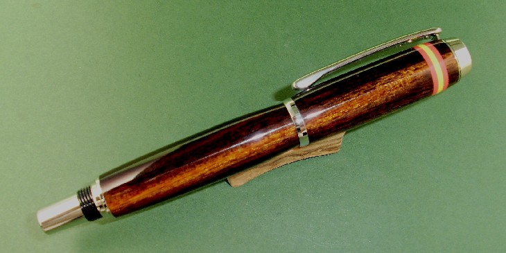

Just don't use the black ring nor the upper plated ring. Here is an example:
