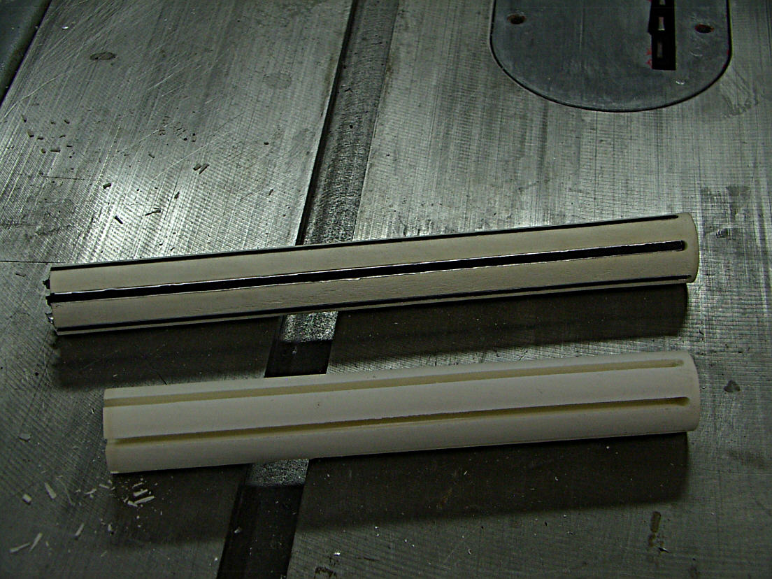

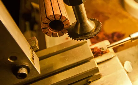

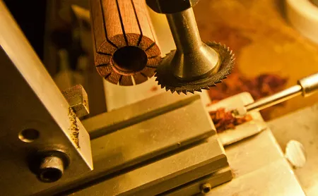

Several ways to do that, table saw, router table. metal lathe with a live cutter and a indexer, a mill .

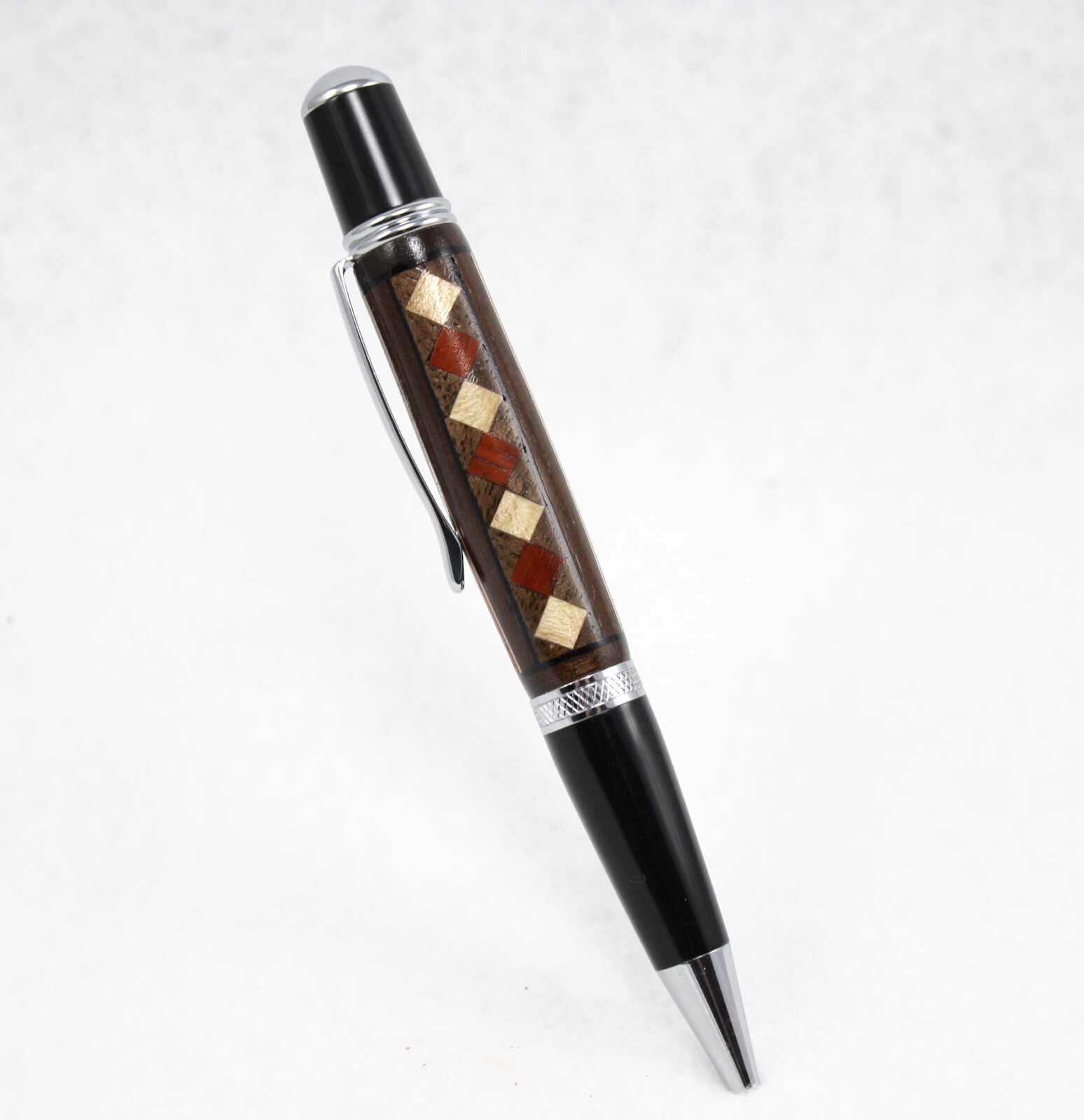

If what you saw was recent, I'll suspect it is Alan's work: https://www.penturners.org/threads/masculine-or-feminine.174212/
He also has more from previous threads: https://www.penturners.org/threads/recent-experiments.173647/

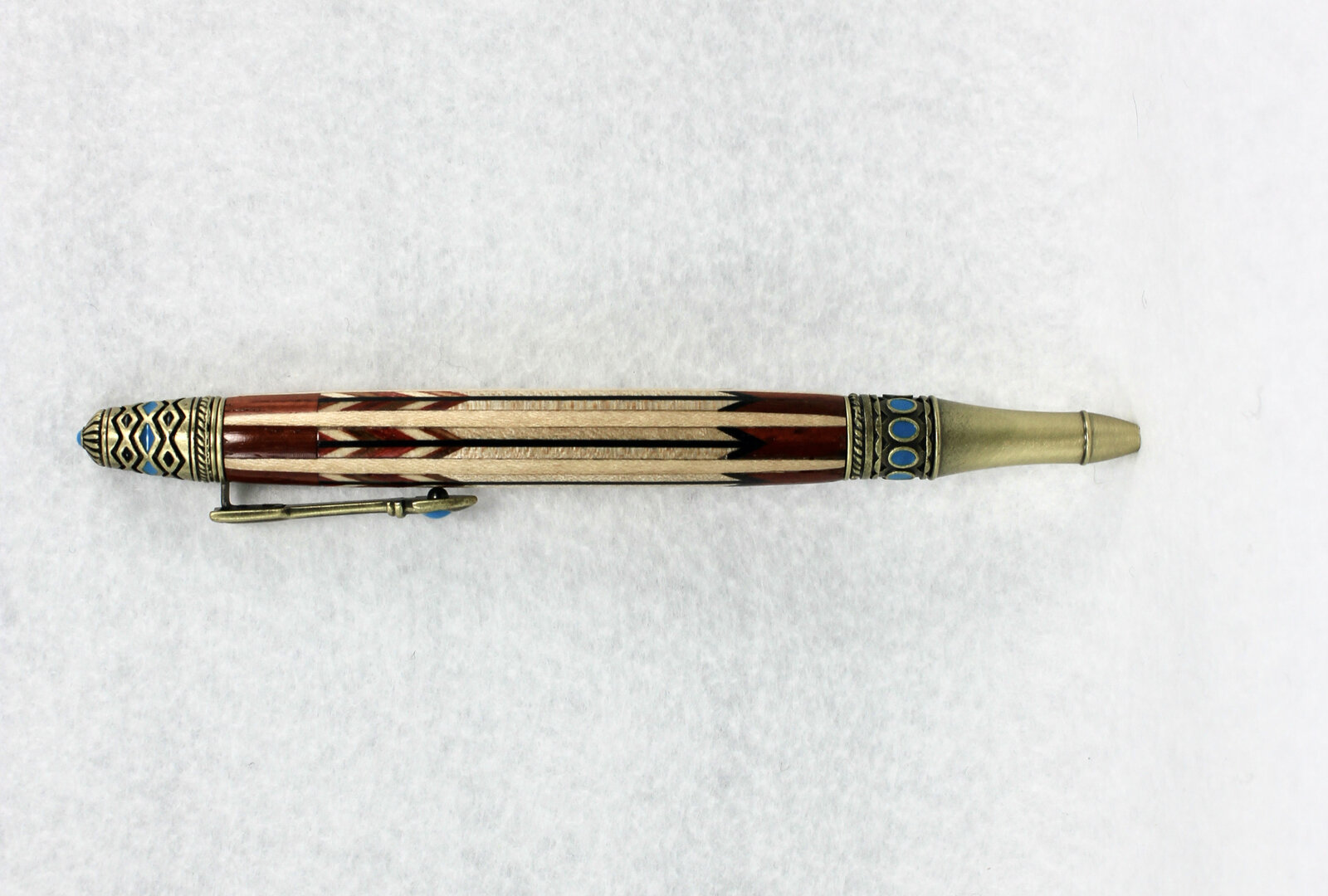

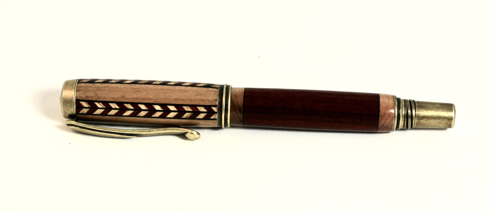

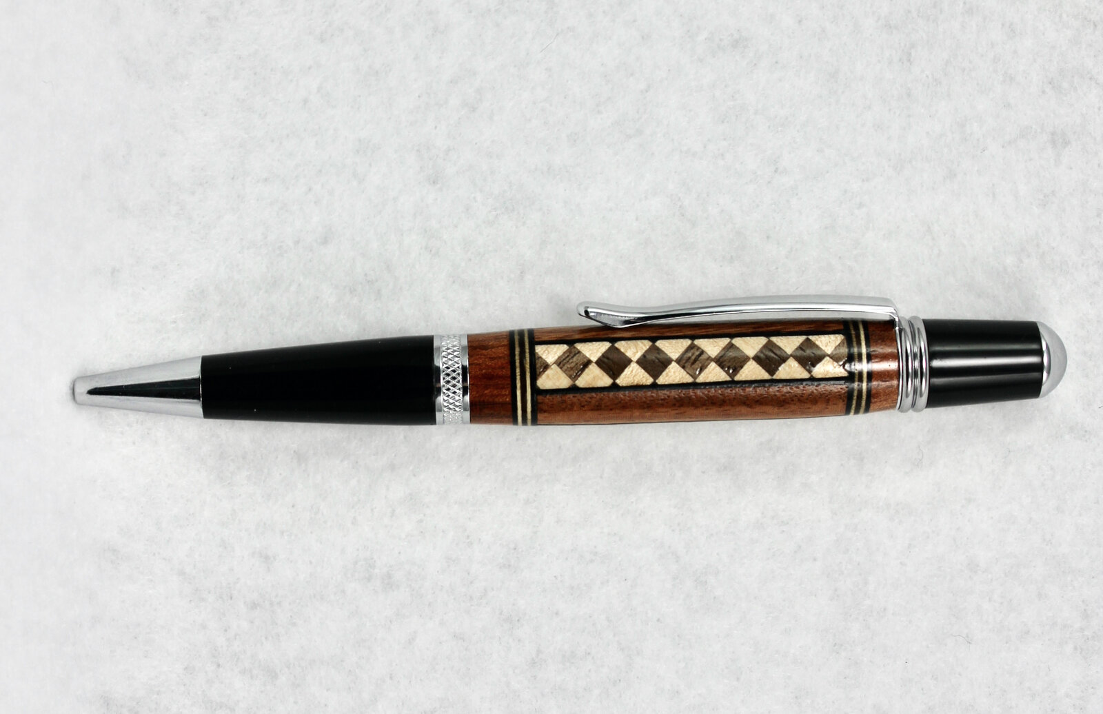

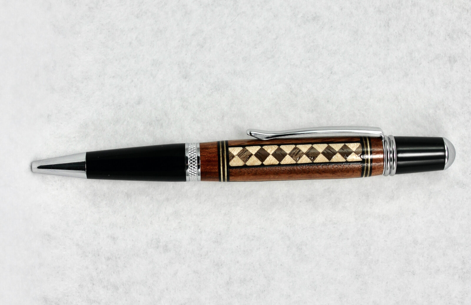

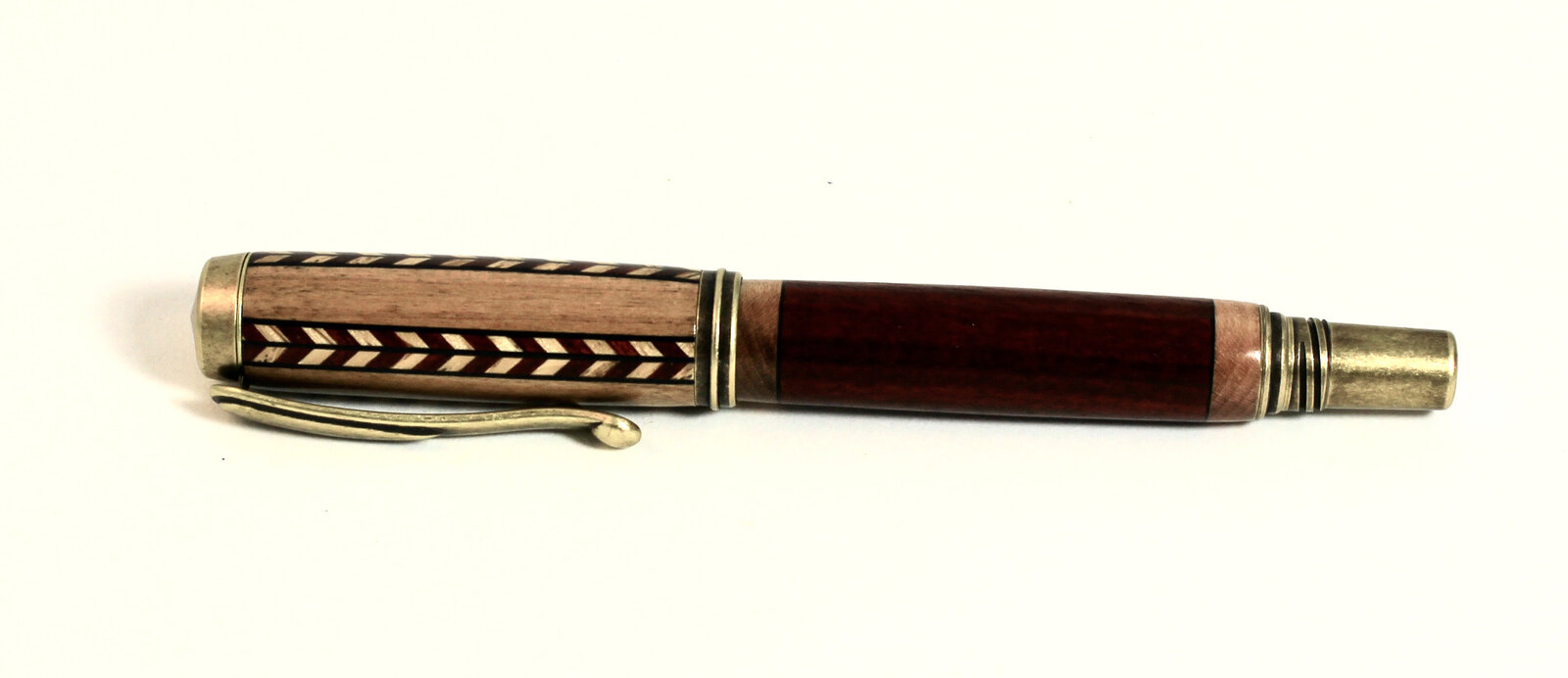

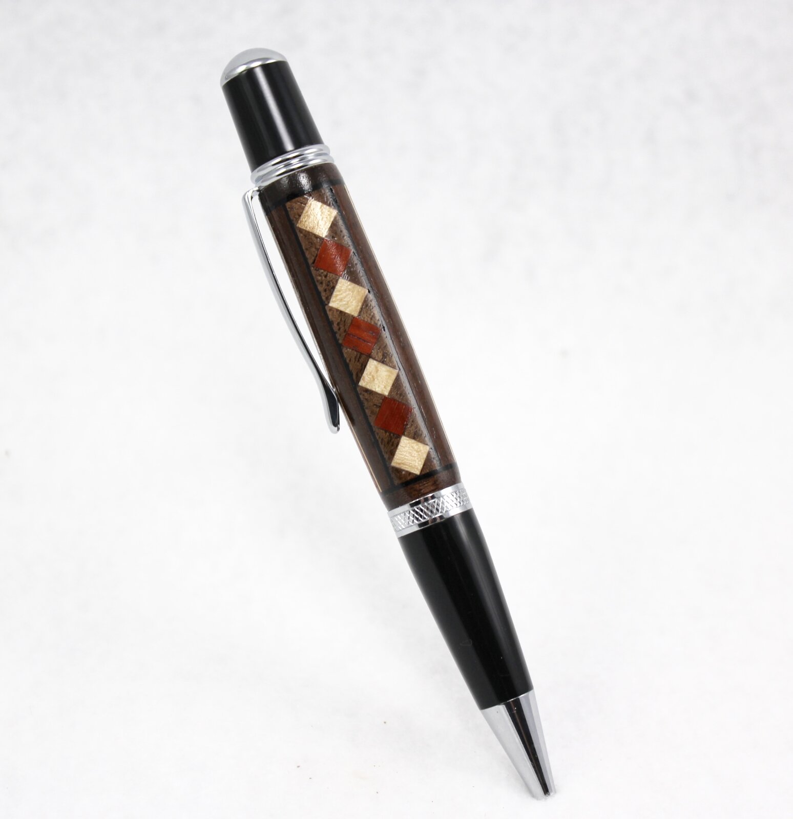

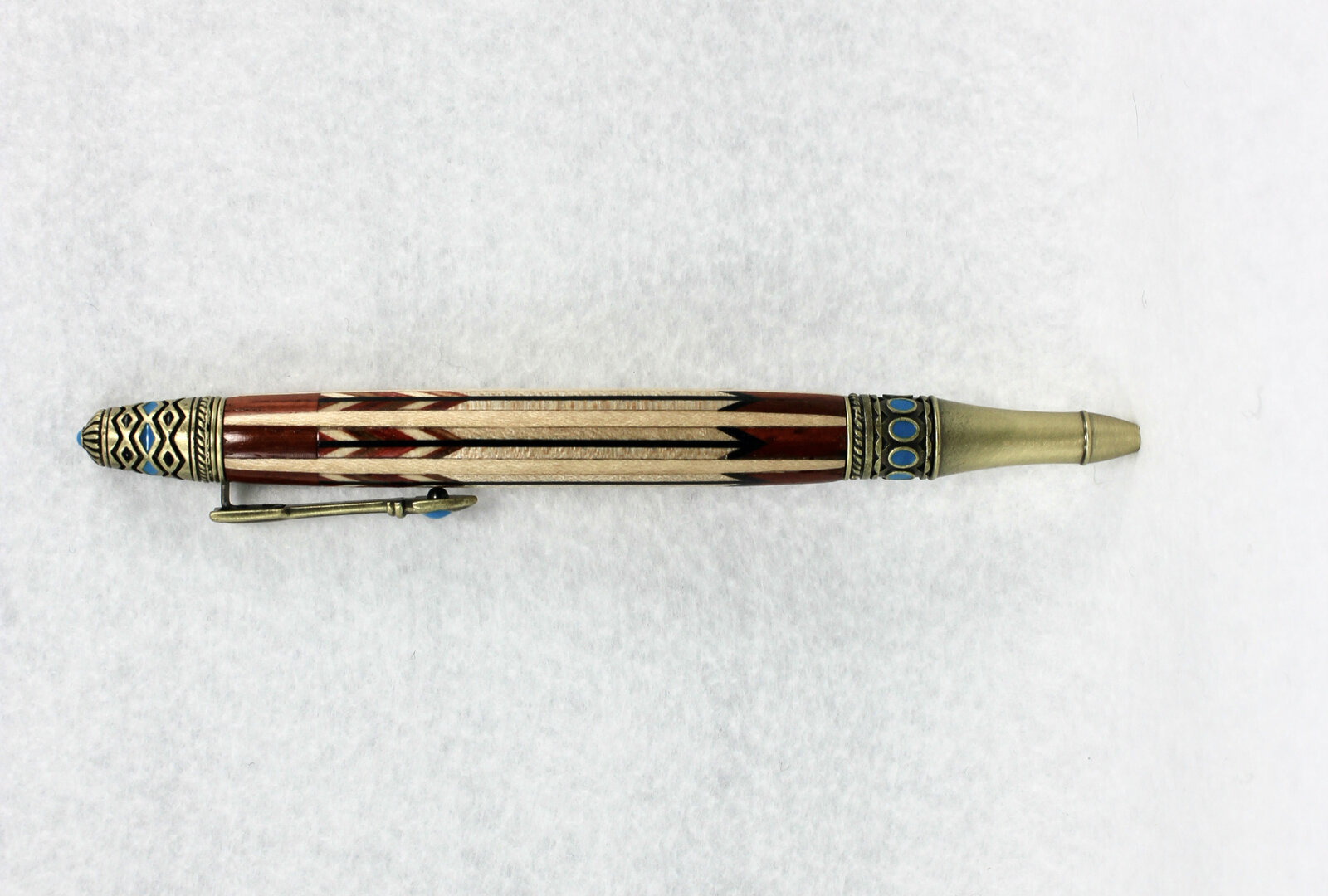

In the past, I have constructed 2, 3 and 4 sided designs where the 'inlay' matches on all views. The 2 sided ones are easily built to extend completely through the blank. The 3 and 4 sided need to be assembled either with cutting slots, or staves. If you have not looked at it yet, the Segmenting area of the IAP Library is a great resource.: https://www.penturners.org/threads/index-menu-of-all-iap-tutorials-last-update-4-2-2022.160513/
Alan does display/his process in his posts.
Here are some that I have done. Alan has used Guitar Purfling as well as making his own inlays. I have constructed my own.
Have fun!

Farmer showed the most practical way, IMO. I have done it with a precision jig and slicing (making grooves) with a thin carbide blade (1mm) on a custom made bench top table saw. It was hit and miss for me, but it worked perfect once! 😌

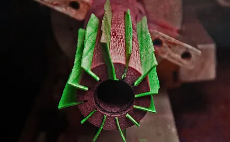

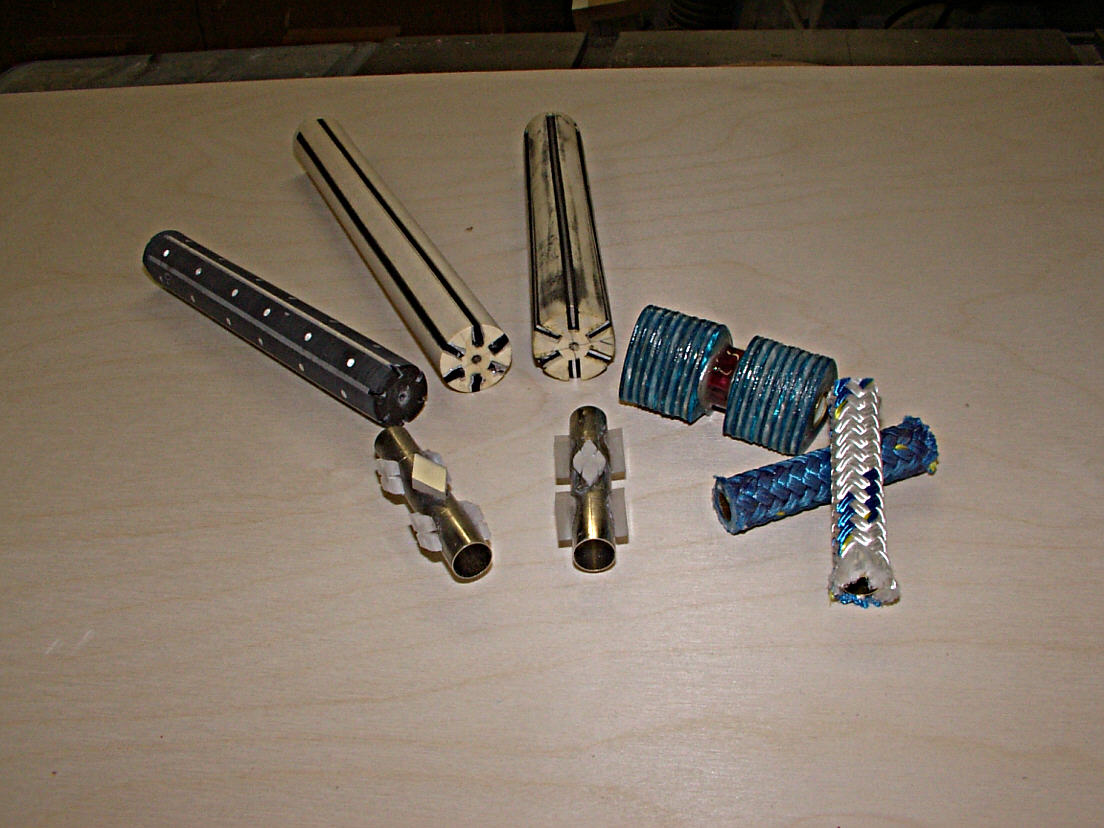

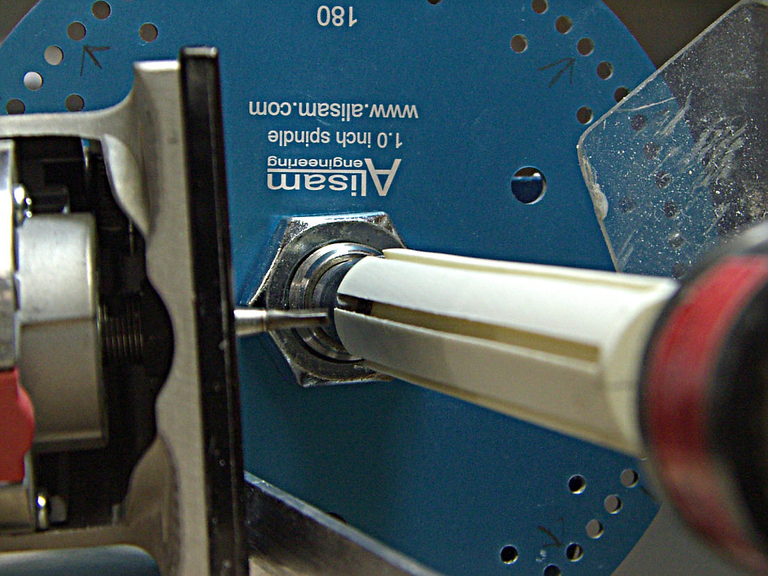

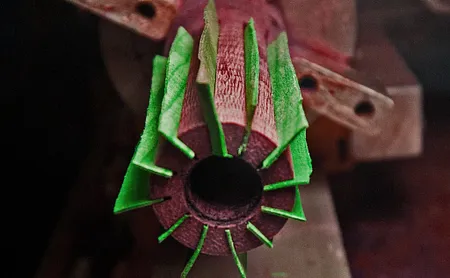

I use a router on a jig made platform to make slots and dots and other designs in combination with my lathe. I can make any size slot I choose. Here are some examples.
