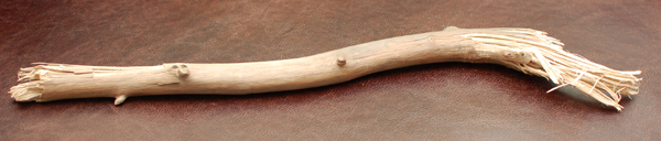

On a recent camping trip, my daughters and I picked up a stick and we'd like to make a pen from it. It was from a fallen tree that looked like it had been there for a while-dry with no bark, smoothed from the weather.
My question is this. Should I try to do anything before I start? The only thing that came to mind was to put it in the oven (low temp) to make sure it's dry, but I'm not sure if that would do anything.
I don't have a way to impregnate with resin and I assume any type of hardener on the surface will just get turned off.
I'm trying to post an image now.
Thanks!
Here's the image
From your comment about turning anything topical off, I am thinking you want to cut this limb into blanks (or a blank) and turn it into an everyday kit pen correct? If that be the case, and it was me, i would just go to town on it. cut it, drill it, mount it and go.
On the other hand, that wood is kinda plain looking from this angle. is there some spalting or something going on inside?

Thanks. It is a bit plain but does have some color variations. My kids picked it up and it's not really a "great blank" but more a "blank with a great story". I'll post a picture it when it's done.

I have been told that you do not want to turn wood from it's center. that is to say the center of the log being the center of the turning. At the same time I see people do it all the time even with really large pieces. I am not sure why but you might want to keep an eye out for strange things happening as you turn it. I have done it once and the wood I used tended to want to peel. that is the best way I can describe it. If it happens you will know what I am talking about it. I managed by just taking light cuts and started sanding earlier. That is just a nicer sounding way of saying I finished up with a 60 grit skew.
I actually like the blanks with a story better. I have a bunch of blanks that came from someones great grandfathers old barn, or the cherry tree in the back yard. all of these blanks came from my friends here at the IAP and all of them will eventually become part of my personal collection of pens. In a way each of them is sharing a part of themselves with me. No price can be placed on that.
Cut off the frayed and craked ends and see what you have to work with. As long as it is dry, it shouldn't crack to bad. You will be able to tell what kit works by how much wood you have to work with. If it does crack, dremel it out and fill with somethig else that goes along with the story. CA the crap out of it, finish and voila.

Turnings are best made from tree trunks, not branches or limbs. You may turn it okay, but have it crack on you a few days later, even if dry, because of the fact it's from a limb....there are wierd stresses in the wood that can do strange things, especially when made as thin as the walls of a pen blank. I tried to do the same thing with some branches cut from my in-laws tree, but it cracked pretty bad and I couldn't salvage it.

It's drilled and the glue is drying...
Making an Artisan, only kit I had on hand besides a Rhodium Jr. Gent

I have one of those pen's my mom picked up a piece of mesquite tree limb laying in a parking lot and told me let's see you make a pen out of that. I did and and now she won't let any one use it. the only thing I did to try to stabilize it was after I drilled it I ran thin CA down the inside of it. then I hand reamed it and glued in my tubes and turned it.
my son was doing some work in my back yard a few months ago and found a limb that was on the ground and looked like it had been there for a long time. It appeared dry. I cut it into pen size and turned away. I had some cracking issues that I fixed with CA. I finished it with about 10 coats of CA and it turned out great. He loves the pen. I had some extra and made one for a friend of his as well.
