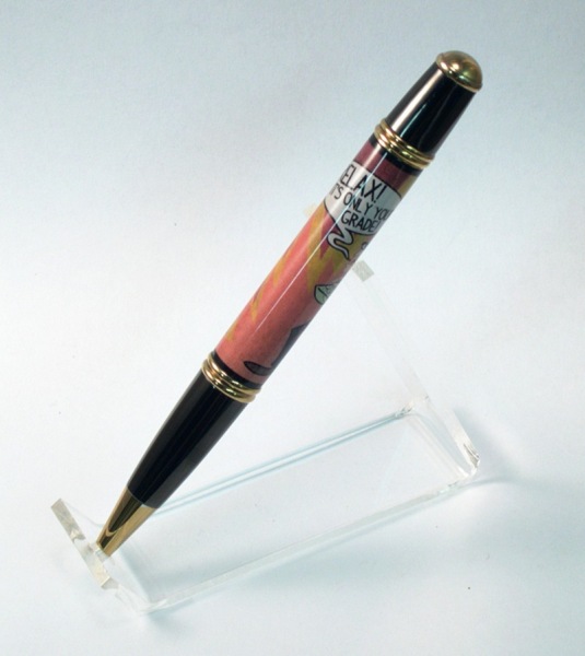

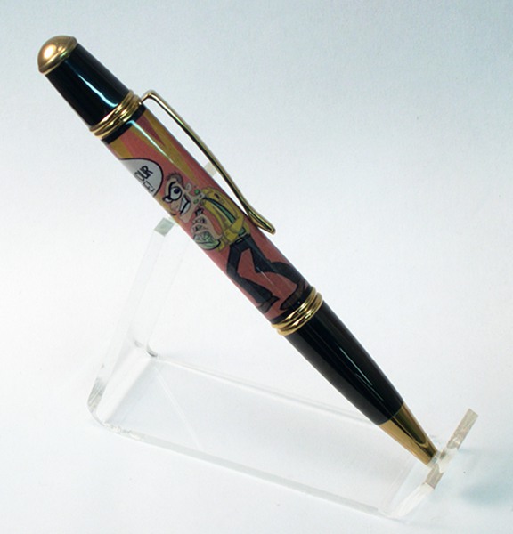

Here is a pen for my son's favorite teacher (Chemistry). He had someone do the art for him. A characature of his teacher with his favorite tag line "Relax, it's only your grade!"
I was having trouble with the label casting, and my son was getting anxious about this, so instead of casting we built up a bazzillion coats of CA until it was a little over sized, then turned it back down a little, and finished.
The CA method is fine for the occasional pen, but If I ever want to do more I think I'll want to work out the casting technique. It used about 1 oz of medium CA. I'm sure Monty would be very happy about this technique as now I'm even closer to needing a CA re-order :eek:.
